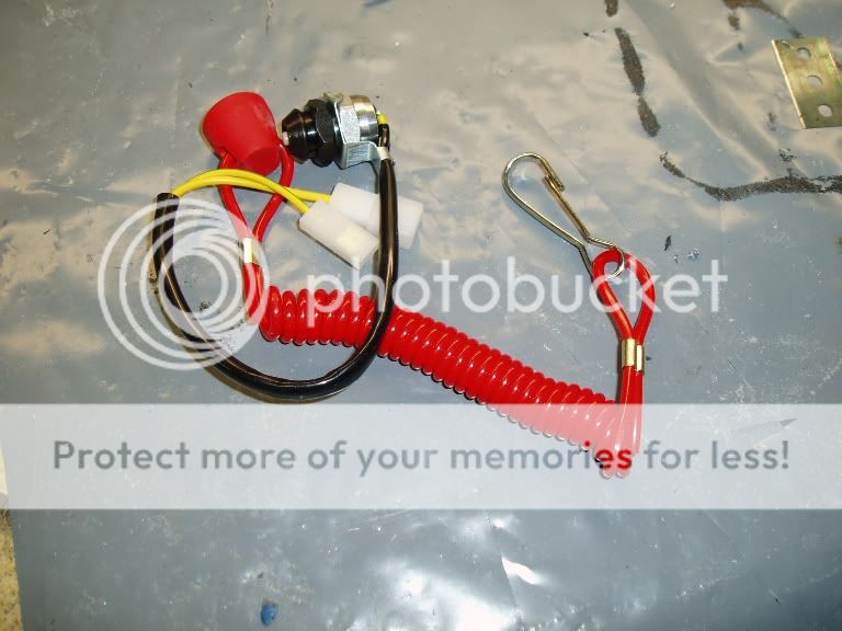

You need one of this, the switch shall be of the type NC = Normally Closed

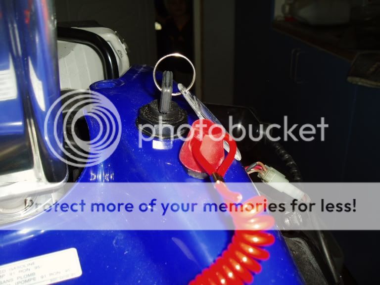

I did mount it next to the key, near to the cables where to connect it
I did cut the brown cable
I di solder the both cables from the switch with the brown cable
The cover with shrink tubing
Then just to put all the cables back and make a nice wiring = FINNISH!

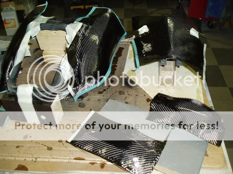

Part to be covered with CF

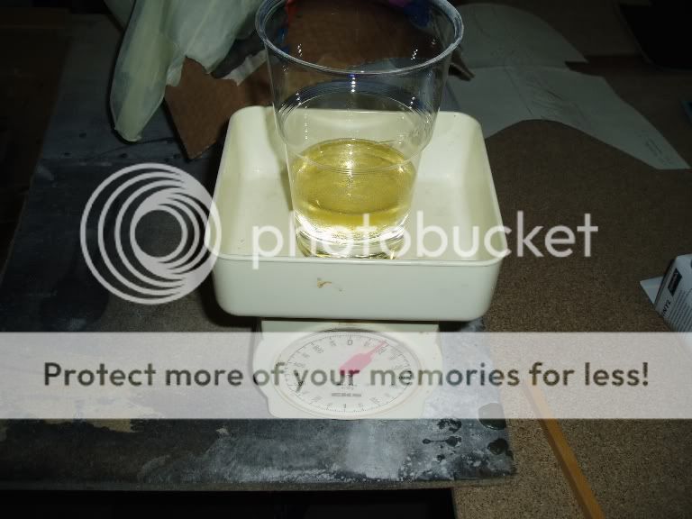

I am using a scale to get the right mixture

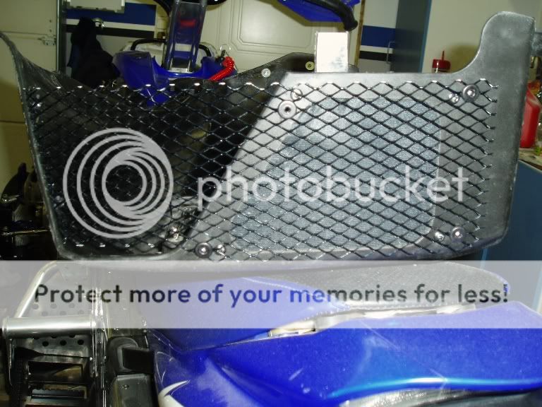

Made a grill infornt of the radiator

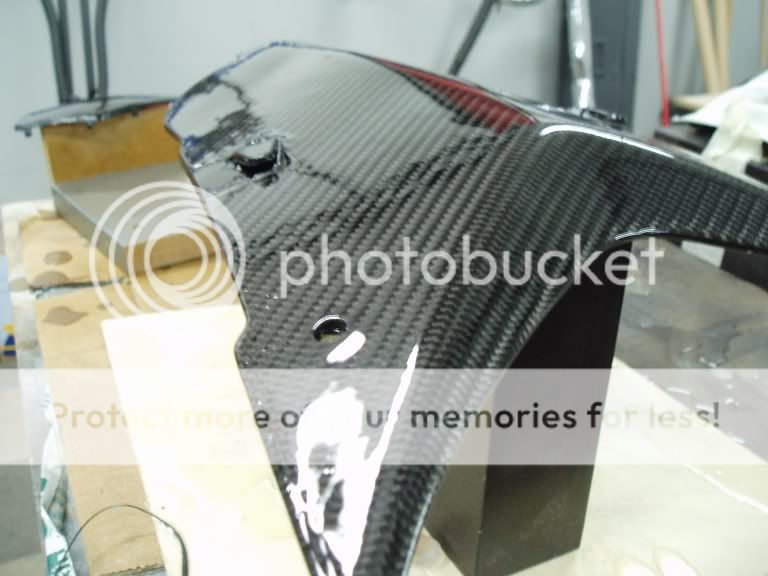

A lot och sanding the CF parts
The result after all sanding and then some clearcoat

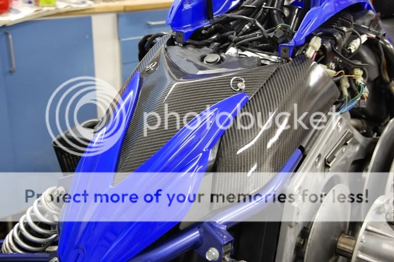

Chris600
The CF parts finnished and mounted on the sled
I love the parts you have made - I know there is a lot of work behind them. Mod sled of the year!!!!!!!

wow! yamaha and powermadd could learn a thing or two from you!! your CF work is amazing!

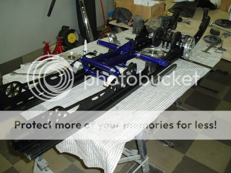

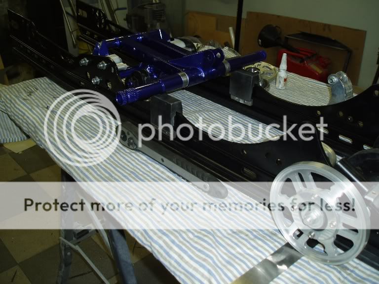

No I have strated to assemble the skid
Homemade aluwheels
Homemade aluwheels

Looking good! I have the rails blacked out on mine as well as aluminum rear wheels and I love the way it looks. Keep up the great work!
