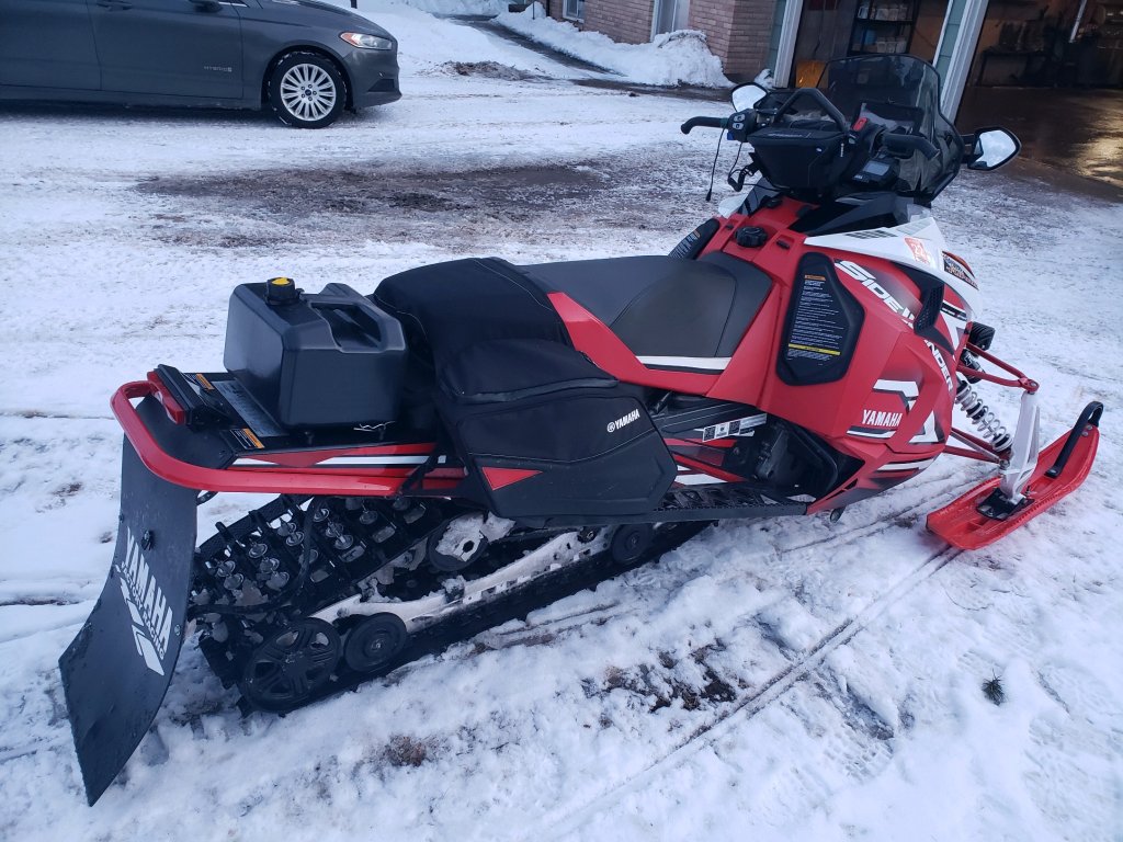

Is that the Kimpex connect system?
number1kyster
That looks like the BOP plate and brackets. I have them on my 129 as well.

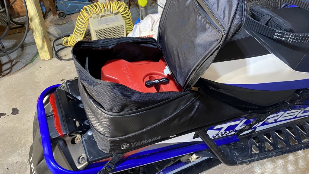

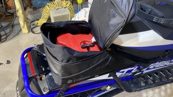

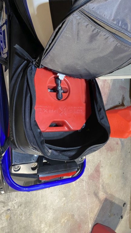

I also had a Trail Tank on my Nytro.
I installed a 1.8 gallon RotoPax in my soft tunnel bag. Made a simple bracket out of 1" x 1/4" aluminum flat stock. Attached it to the tunnel with 2 bolts and tapped the bar for the fuel bracket. I also have the saddle bags for overnight trips.

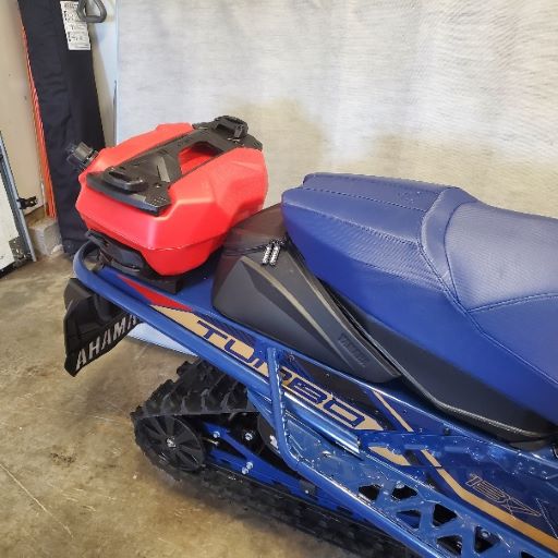

Up north technology bracket and BRP linq 14L fuel caddy stackable.Is that the Kimpex connect system?
Sevey
- Feb 15, 2011
- 1,746
- Collingwood, ON
- www.ty4stroke.com
- 2018 Sidewinder RTX
I have the 15L Linq can as well with a UNT single plate on my 129.
Standing that can on end, you can get a little over 17L in it.
That will bridge some gaps with fuel stops if required.
