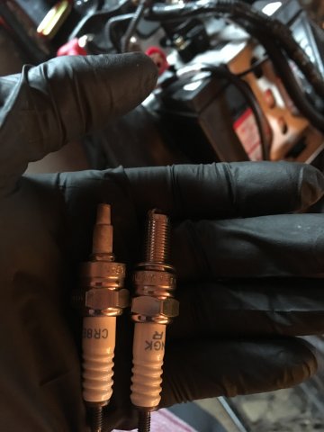

sledder91
Yamadog
Yikes
Holy xxxx! Did you get the threads out?Look what happened to my spark plug inside the hole. Thankfully got it out.
Robinmaine
I've had plugs break. But never anything like that
Sent from my SCH-R970 using Tapatalk

Wow! Did the threads stay in the head?
Pstn head
How the hell did you get that out ?????
