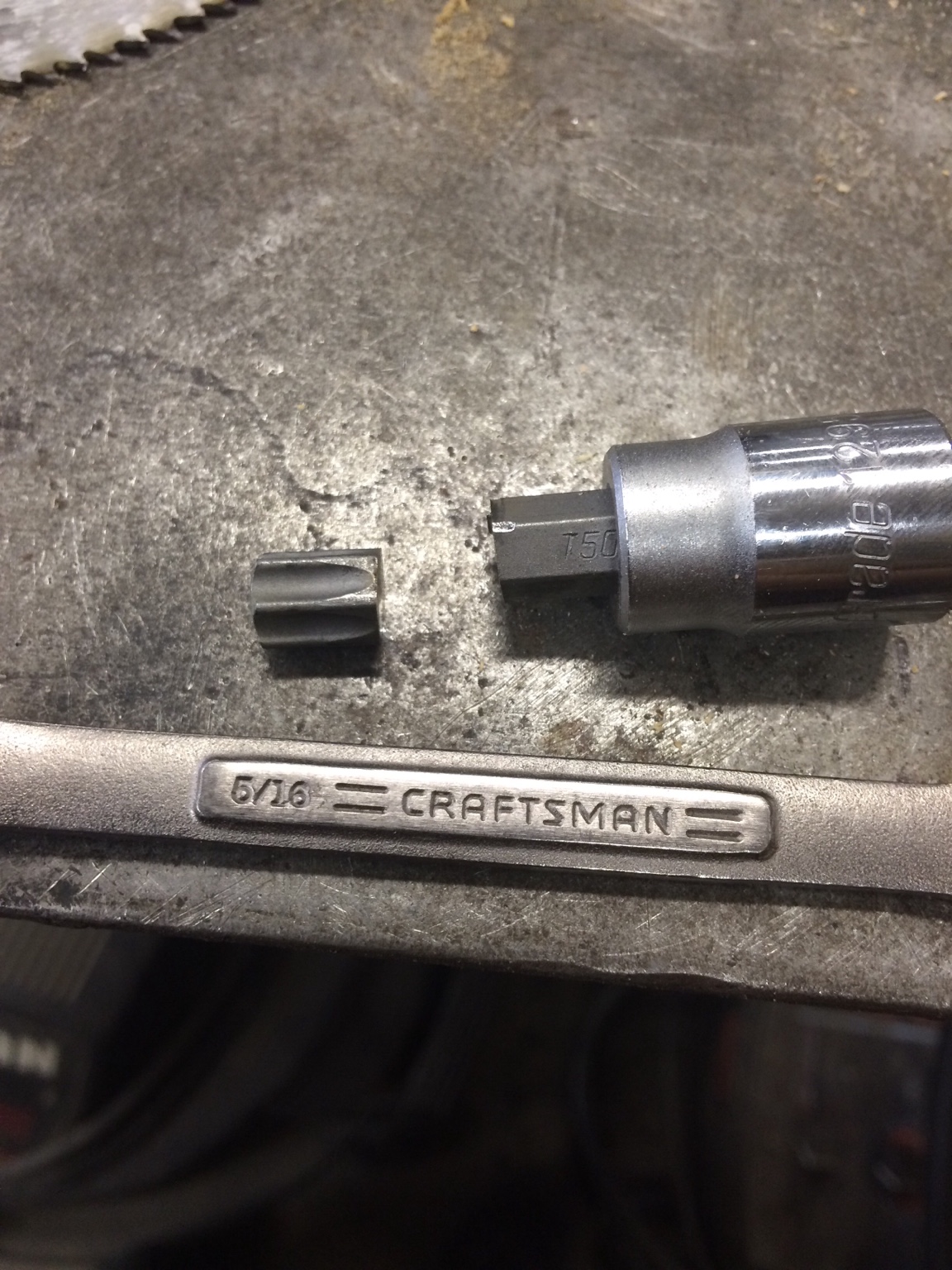

I made a tool to make it work

Going to get a t50 right now, to make sacrifice!
Thank-you so much....... Joe

Lol, i did the same. I couldn't cut my craftsman one.Going to get a t50 right now, to make sacrifice!
Im going to buy a cheap 5/16 and weld the t50 to it so i dont loose it when it falls into the sled.
