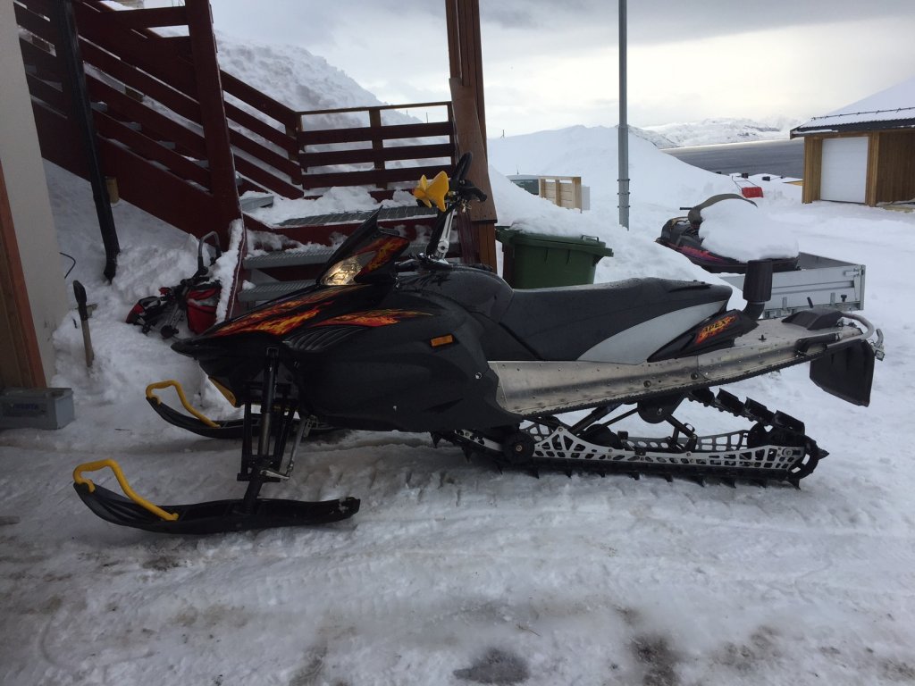

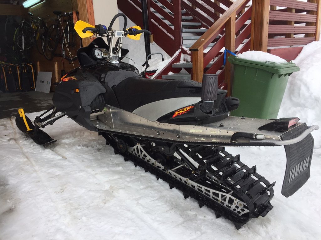

I put a m1000 skid on my 06 mountain last year. It works better than stock, and it sure is lighter.

Hey I seen this I am doing the same thing to a 2003 rx1 was wondering if you have any measurements or any tips for installing it and your front end looks like there is lots of clearance is that an after market front end??

Long time since I were here. In the photo there is pioneer wide front end (45"?) with fox floats from an arctic cat. Nowadays I run stock apex width (42") with ohlins ttx shocks.
When I put the skid in, I had to reinforce the tunnel in the front (you see the metal plates, and then riveted stainless plates inside tunnel.) and moved the rear drop brackets a bit forward. I used the measurements from a thread on here with putting this skid into a nytro (search and you will find..) as a basis. Then I put the skid into the track, with the tensioners loosened, and placed the sled in the position I found best (height wise). Then I measured where the holes would be, while pushing the skid backwards. Measured, measured again, measured again, marked (compared what I got with the basis measurements from the nytro thread, so that I wasn´t to far off..) and drilled. If I remember correctly I put the rear drop brackets so that I didn´t have to drill them.
Good luck, if you´re doing this.
