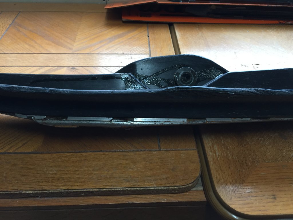

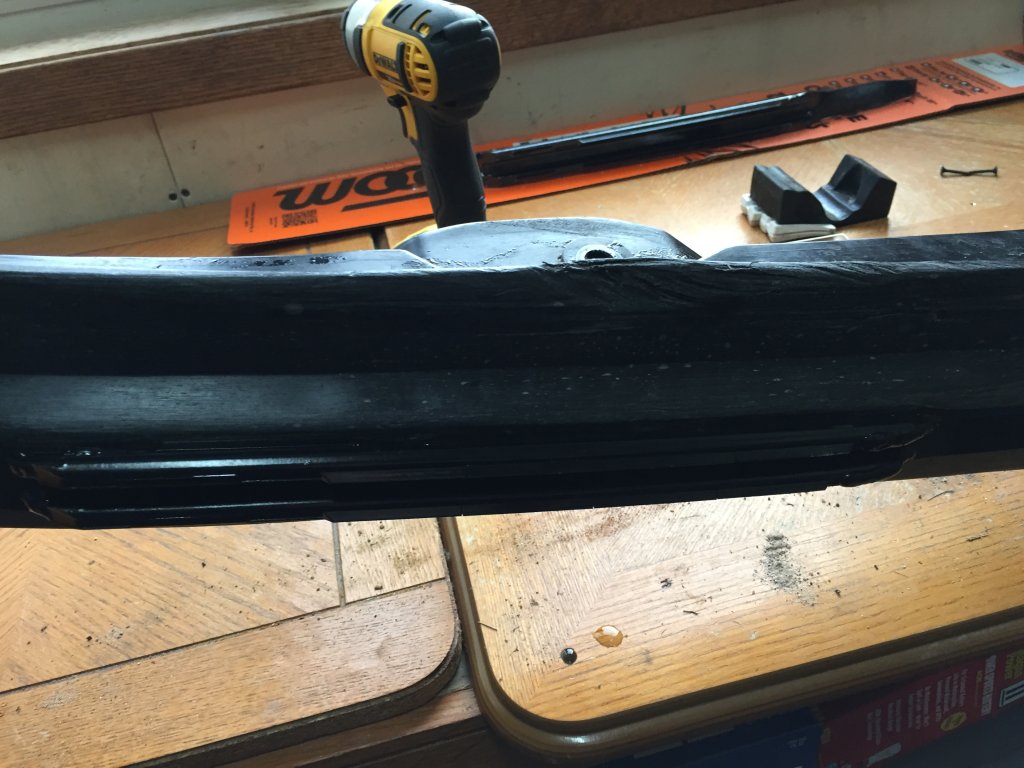

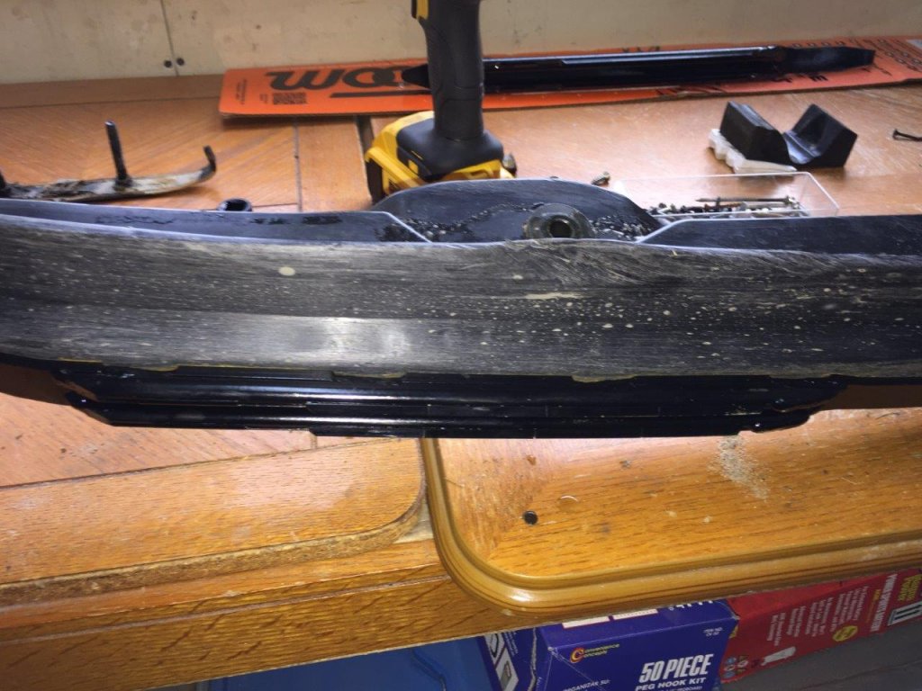

So it was obvious that I was in need of new carbides during our last couple trips on my Apex XTX. On packed snow, I was pushing hard. I was thinking it was the 1.6" Ice Cobra pre-studded track I had just installed.
Nope, the front half of my Woodys dooleys were worn down to the flat bar on the bottom of the ski. It was also obvious that I need to shim my skis in the rear to even the wear.
I am not paid by Woodys but if I were to endorse anything for durability it would be their traction products. I am sure I put these on in the first 1000 miles and I am now sitting around 5700 miles. What does that tell ya, and many miles were in less than ideal conditions.
Here are some pics, and yes, I went with 8" now that I am getting more traction in the back. This sucker is ready to rock the hard pack this spring!!

Not really sure as it is a great question. I was not seeing the benefit of the Slim Jim's other than they may have less drag and that may have been a big bonus. I would bet they would perform very similar to Snowtrackers in their design. I had good luck with Dooley's so went that direction again.
I did go with 6" originally since I had the XTX, and it worked out really well and seemed balanced with an unstudded track. When I switched to the pre-studded ice cobra, I did notice push in the corners. this could have also been from the wear on the dooleys as well. I will find out now that the longer 8" are installed. Either way, I was very impressed with the wear. We have run quite a bit of plowed road in the past few weeks, so I am sure quite a bit of wear has been in the last month. And I suppose once the carbide is gone, it would eat away at the runner.
