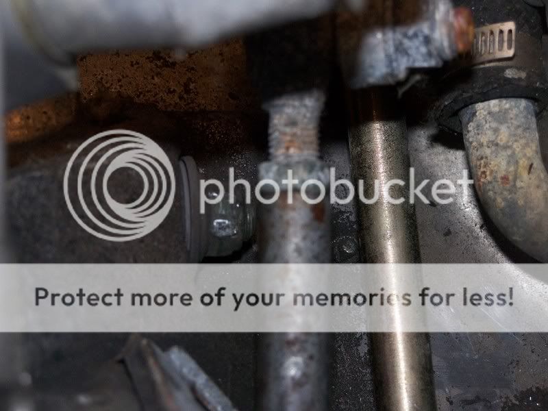

I know I said I was going to wait till all parts were in but went out Friday and checked the front A arms and WOW they were bad.
So I started in on the updates yesterday by doing the front bushings and temp gauge from Allen. I wanted a cooler for the 136 but was sent one for a 121 made it work for how long.
Getting ready to replace the bushings skis and front cover off
Heres the difference in the bushings granted one is worn out
It tightened up the front so much the left side is done and and right side just hangs down
Now there is one thing Allen didn't tell me is that you might have to slide your sway bar out of the way to get the bottom A arm bolts. Not a big deal.
Bushings are done But I replaced 32 and could only find 27 the other 5 were completely gone no trace of them no damage to bulkhead or A arms there were missing them.
Heres what I took out some good and some junk.
Just follow Allen's directions for the Digtail Temp and its a breeze to do except for it needs longer wires. (About 3 feet longer would be nice)

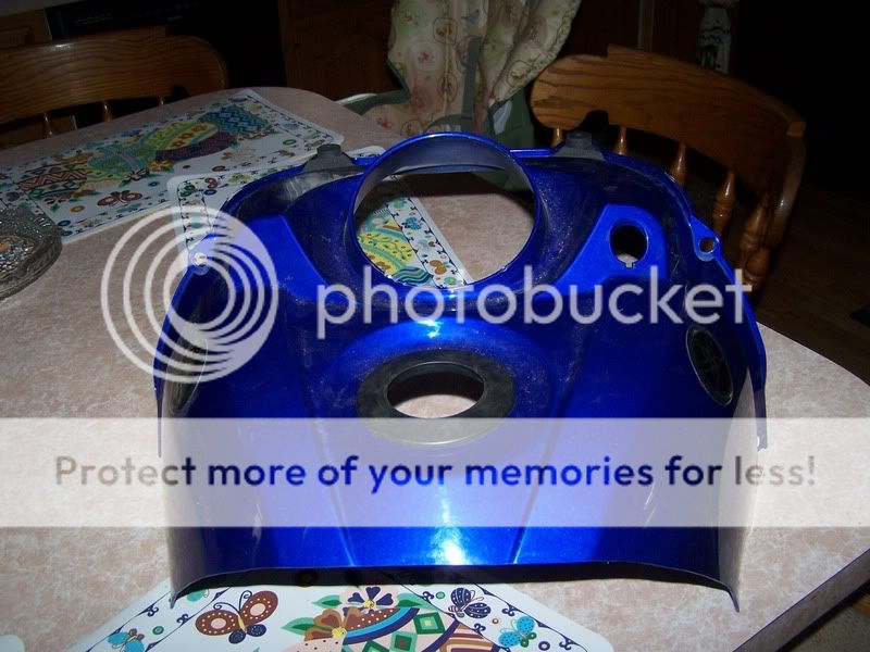

I came home from work and found a box in the living room.
Heres what was in the box.
The Apex seat and tank cover that I bought from UP Brett Thanks
My son just had to get in the pictures as you can tell
I wont complain about my son hes Daddy's little helper he wants to help work on the sled. Going to start him off right by working on them before he rides them, so he will learn to respect the work that is put into keeping it running.
