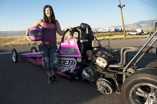

I have a 06 apex engine in a dragster. I have always run pump gas 91 octain. Just wondering if any one has run race fuel. 110 or 112. am not sure if there is any performance to gain or waist of money.
Motor is bone stock
custom air box
custom header
4600ft
1/4 mile
pc3
Thanks Ray

Total waste unless you are running more timing than stock.

Agreed. Not going to gain much of anything besides a lighter billfold.... And exhaust smelling better. [emoji38]

Very cool car! How long have you been racing?

Ray,
It will make the most power out of oxygenated pump gas... Running 10k+ RPM it likes fast burning fuel. Higher octane race fuel burns slower.
We ran oxygentated 87 R+M/2 Octane pump gas when we grass drag raced stock Apex's, ran the quickest...
Mauri
