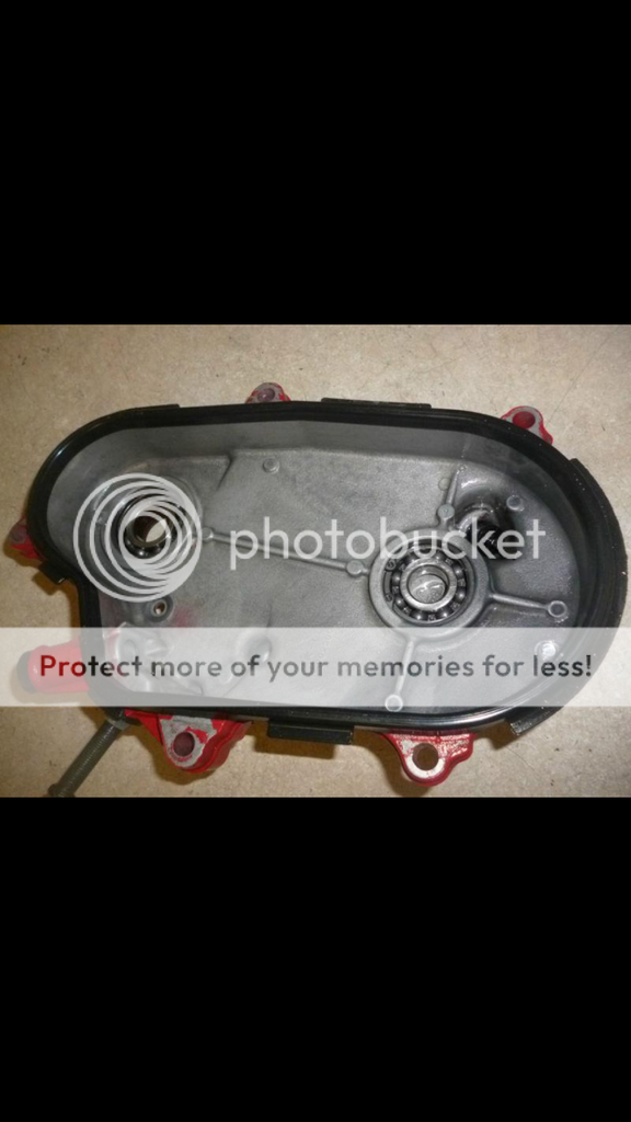

Nytro chaincase vs Apex chaincase. The non reverse setups are very similar in design with the brake caliper being mounted to the chaincase cover.
Apex setup.
Nytro cover
With both setups being close in design, the Nytro cover has an additional bearing for the driveshaft in the cover. I can't imagine this is for driveshaft support. My thinking would be cover support because the caliper is mounted to it, but the Apex has no additional support and they don't have any issues.
Of course I'm looking at this from a weight perspective thinking the Bearing could be removed and driveshaft cut shortly after the nut.
Stupid idea? Yamaha overengineering again?

Being familiar on this topic because I have the 06-09 apex chaincase. There is a lot of pressure on the driveshafts and many like myself upgraded to the micro HD shaft which goes from 1.061" Hex to a 1.25" hex shaft. Its also has a another strengthening process done to is like heat treating but not sure the right name off the top of my head. This shaft is almost bullet proof in the apex chaincase. Myself and others will pound this on rough trails/ditches with 250+ hp boost and it wont give up, nor will the case. Around 10K miles on the stock shaft they seem to break more frequently on stock sleds, boosted shortens this further. The HD shaft in a HEAVILY run/abused sled will still break but only MDKUNI is the one I know about it, and he drives his sled then most do their cars. If you remove him then its safe to say its bullet proof.
In 10+ they revised the chase and lengthen the shaft to include a bearing like the nytro. It also seems to fix any issues with the stock shaft.
Lastly I happen to have a 07 non reverse case sitting on my shelf in perfect shape if you needed anything/pictures from it.
Thank you!
Thank you!

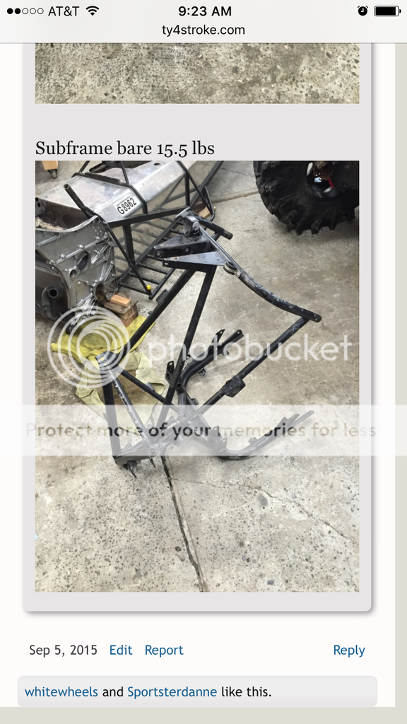

I meant to also ask, you posted this before but I can't find the page where its mentioned but what does your front subframe weigh? The apex diecast front clip weighs 18lbs. This includes the suspension mounts, shock mounts, and houses the ECU/Regulator, etc. I was wanting to compare to a uber minimalist tube front end like yours. I am a super fan of the diecast unless you tell me it can be built for like 3lbs out of tube LOL
Nikolai
Thanks for the info, sounds like that extra bearing needs to be there.
I found the post with the subframe weight, it is 15.5 lbs.
It could certainly be made a lot lighter since I reused some factory tubing and could simplify it starting from scratch. I bet if I jig'd mine and used all new tubing I could get it under 12 lbs, maybe even lighter.
IMO, a full tube chassis could be built lighter(if smart with the tube design) than reusing the diecast sides by a couple lbs. I do have plans to build a tube chassis after mine is done and I'm 100% confident it will be under 400 lbs, especially I do my belt drive. Lots of ideas in my head, just not enough time.

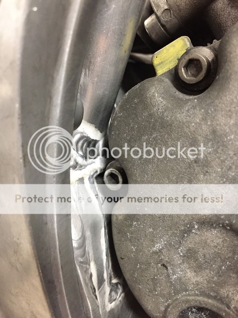

Been working on the cooler when time allows.
Piece for the starter.
Piece to clear crankcase cover
My aluminum welding isn't the greatest so I ended up grinding the welds around the starter piece flush and welded over it again. The sides of the plates were a little bit of a pain. I shoved scraps of 1/8 and 3/16 in the gaps then welded over them.
This is where I'm at right now. Putting it back in the sled to fit the tubes.
I also bolted some pieces of heavy steel angle to it and was able to straighten it most of the way back.

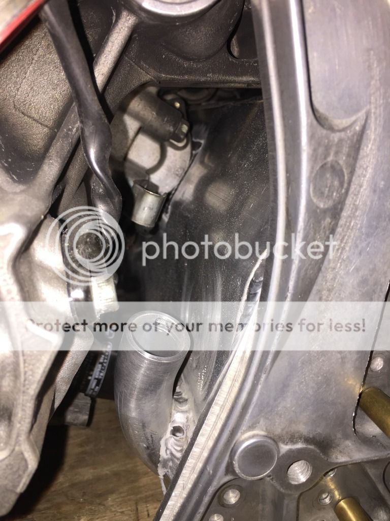

I put the subframe on tonight to check clearance to the lower outlet by the crankcase cover and it just clears. That's a tight spot.

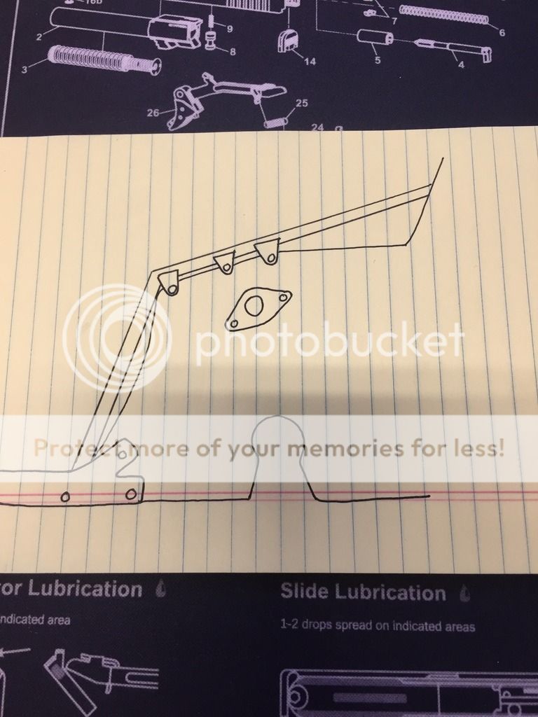

For a long time now I've wanted to figure out a way to modify my chassis so the engine could come out without pulling the subframe. I think I could build a stronger overall structure while also reducing weight.
I was looking at it again tonight and came up with something I think might work. I do have an extra set of diecast sides I can cut up first.
The two 3/4 tubes taped together would be one bent piece and tie into the 3 yellow dots(castings which I would drill & rivet/bolt through), tie into the hoop where it bolts to the back top of the diecast, and be notched & welded into the subframe at the bottom. I'd then have to modify the 3/4 tube from shock to hoop(long piece of blue tape on it) for engine clearance and triangulate it into the bent tube somehow.
The tube would run on top of the diecast with a tab on each side. Excuse my drawing skills.
I should probably mention the chaincase side would be left alone, only the clutch side would be modified.
