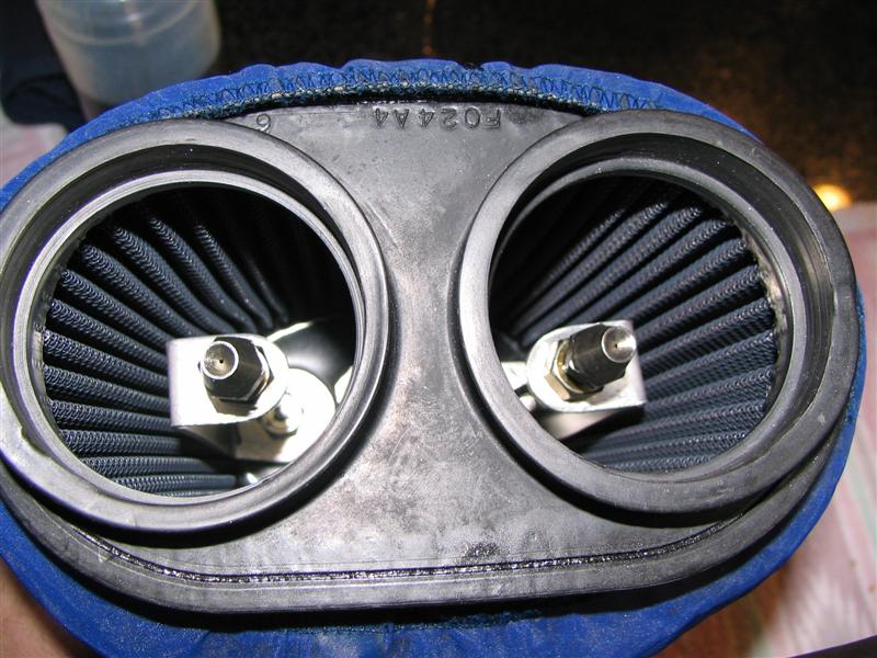

I'm, thinking about the doing the same thing. I have 4 Boss Noss 15 horse nozzles (60 total) I can use like the ones in the picture but not mounted to any bracket. When I used these nozzles with K&N filters on my RX1 I had nothing but problems I had to switch to the Rev style that Boss sells and mount them right in the carb throats . I was wondering if they would work for the Vector with a stock airbox. If so where would I put them?
Thanks Rx1M5
Thanks Rx1M5
