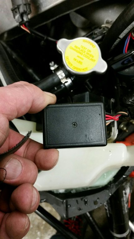

What is that? Turbo controller?Looks like some belt hanging in your hand too.View attachment 125989

Was over boosting and pretty sure I have a stage 2 controller on a low boost set up...from MPIWhat is that? Turbo controller?Looks like some belt hanging in your hand too.
Electronic Boost Units were mistakenly programmed with a Stage 2 code (this code is NOT compatible with Pump Gas and is NOT compatible with a Stock Motor). IMMEDIATELY Discon- nect the EABC using any of the 3 Options described below. You only need to do one of the 3 options to disarm the EABC system. Any of the 3 options will put the Electronic Boost Con- troller into a “DEFAULT” mode which will produce a SAFE 4 to 5 PSI of Boost. There is no safety liability to driving with the EABC bypassed; you simply will not see boost increase as you increase altitude. At some point, you will need to remove the EABC Black Box for Re-Program- ming. The Single Red wire is simply Unplugged. The 2 Wires connecting EABC to the Solenoid are simple unplugged. The MAP Sensor plug to the EABC (3 wires) is unplugged from the MAP sensor BUT, the wiring connecting the GEMS (flat box with 3 buttons and 8 lights) MUST re- main connected. Re-Flashed Units are identified by a WHITE or GREEN paint dot on the phillips screw’s head.
So I'm trying to sort this mess out...as soon as I unhooked the red wire boost was fine...put 3-400 miles on it last year with no gauges...lucky I didn't grenade it.
I am sure some Turbo guys will help you out. I recall a few posts on this subject. Try searching EABC. Good luck!Was over boosting and pretty sure I have a stage 2 controller on a low boost set up...from MPI
