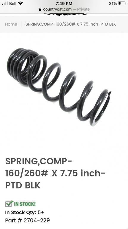

Cat 2704-229 160/260 is working great for me this year.I am 250 suited up. Less bottoming and more transfer with great handling. Just don’t preload it too much. I am at 3 turns from snug. Shout out to Cannondale also for revalving and refreshing my rear shocks. The sled has much more bottom resistance with a nice smooth ride.

what sleds is this cat spring stock on ?I'm running this cat spring also. Big difference over the stock centre spring IMO.
How do you tell what spring you have ?

That part number doesn’t show weight????which model looked like from a 600 but no weight shown

Got it, ordered thanks a lot
