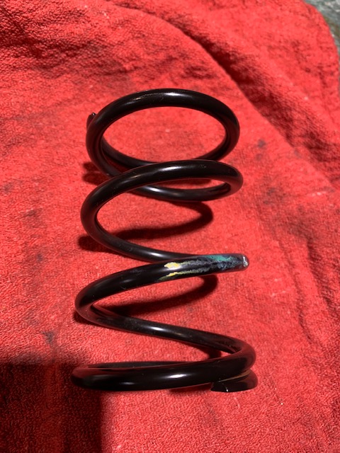

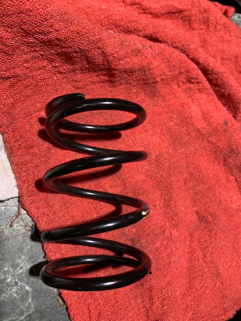

Janne339
Hi,Yellow green yellow Yamaha. 10k + miles. The paint marks got swirled from brake cleaner. View attachment 167340View attachment 167341
Are you running yellow green yellow in your primary?

I did for 11k miles on my 2017 and some on the 2022. I run the Yellow/white/yellow now.. Very close in specs.. Only diff is a very slight higher engagement.. With 911 cover it engages @ 3400.. The yellow/green/yellow was 3200-3300.. Only difference.. I find both of these springs work very well.Hi,
