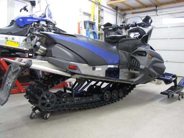

You can see the rear upper wheels here. They are a few inches behind the rear mount.

Nice looking sled @steiner !You can see the rear upper wheels here. They are a few inches behind the rear mount.View attachment 106403
Thanks
