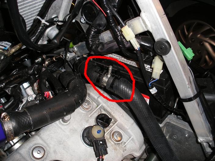

yeah the mcx kits have a small oil run off tank and when the nytro gets layed on its side they drip oil out of the over flow line, most guys take the small black tube out of the stock air box and use it to funnel the over flow to the belly pan,
Tuesday
FLYBYU said:you said you lost oil
Lost a bit of oil the day before the problem and in the meantime had topped it up.
Hope that clears up what I was saying.
Found out it works better if there is a longer tube on the mini reservoir to prevent leakage while on its side or upside down.
I will give that a try.
