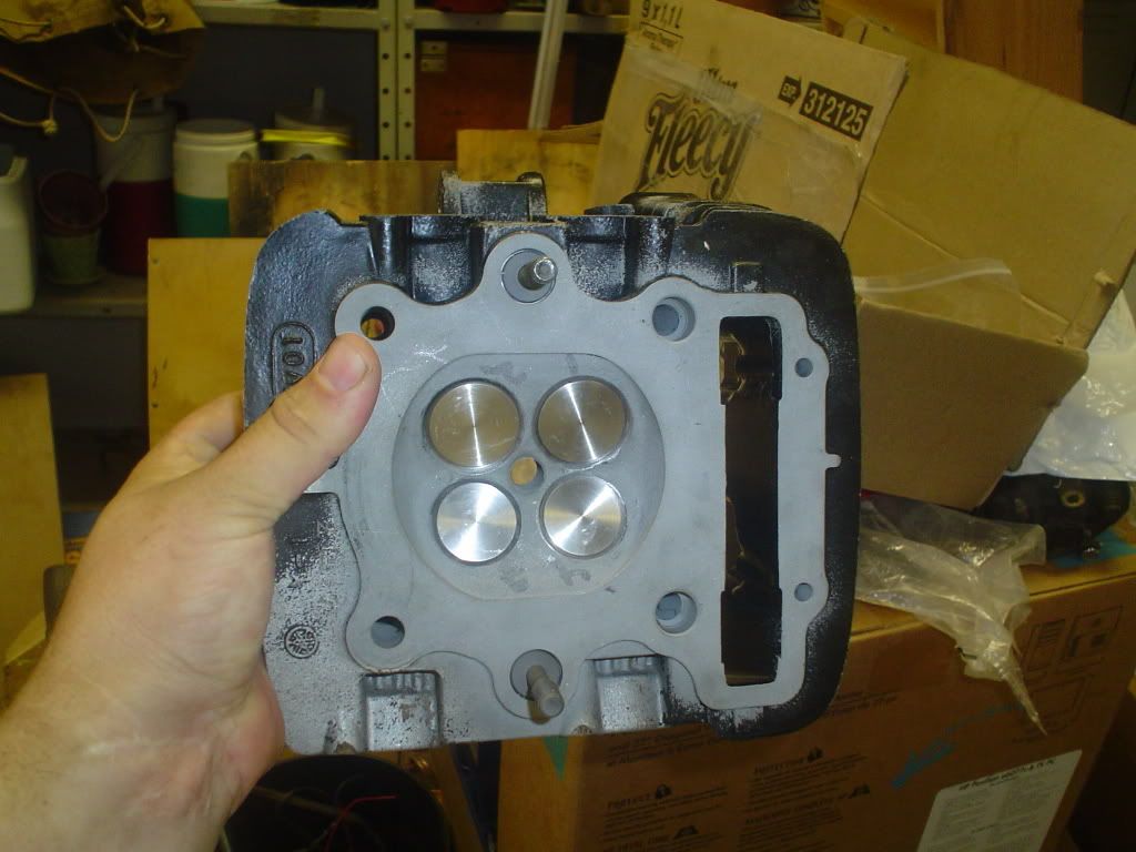

here is a pic of the valves still in the head that i bent in my xt350 when the timing chain broke in it last fall.

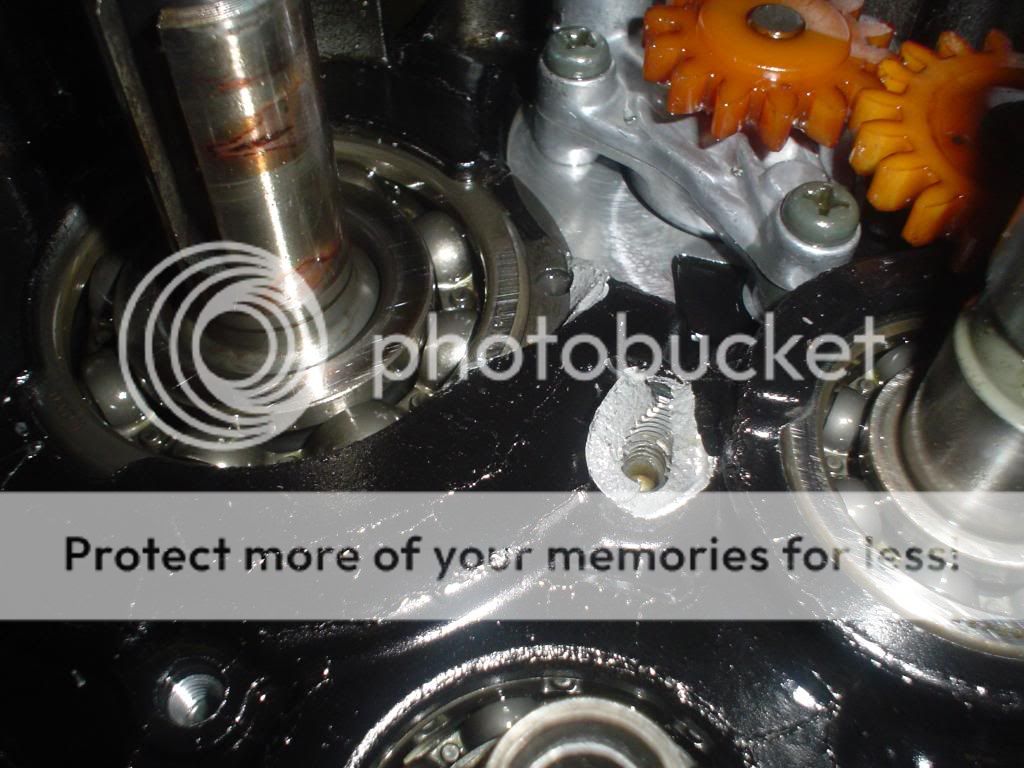

bottom end damage from broken chain

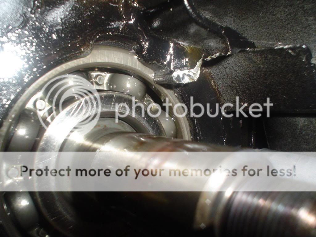

is it smoking like this? this one is smoking from assembly oil and glazed rings. it started clearing up later. it came to the house in 3 milk crates. looks not too bad now.
