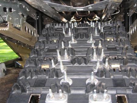

I am thinking of adding the rear heat exchanger on my sled. I am running 1.325 woodys studs and want to know if they might hit the heat exchanger. any info would be helpfull.
I have 168 1.325 in my 06 apex gt...2200 miles not a mark.
I would try going with a little longer stud.

300 Hard miles and not one hit. That is without extra protection. I will be adding an extra 1/2" to the protectors this summer just to be safe.

1.325 studs won't hit the heat exchanger. I put one on my sled and never had the light come on again.
For those of you running 1.325 studs, I assume that's with the 1.25" Ripsaw stock track? Or are some with a 1" track. I'm thinking about changing to a 1" track with 1.325 studs which should also be fine.
I'm currently running the stock track with 1.450 Woodys and after 6500 miles, no issue other than scrapes on the exhaust bracket at the rear of the tunnel.

as to the rear exchanger...a little fuel for thought....if you ever throw one stud and it hit's that thing while under way in the back forty...good luck!
Lastly dont just go with a studs number I.E. 1.325 or 1.380 etc....some manufacturer's measure differently thereby giving you more or less penetration..this is one of the reasons why some guys dont hit with a "longer" stud and other have "touched" with a shorter
