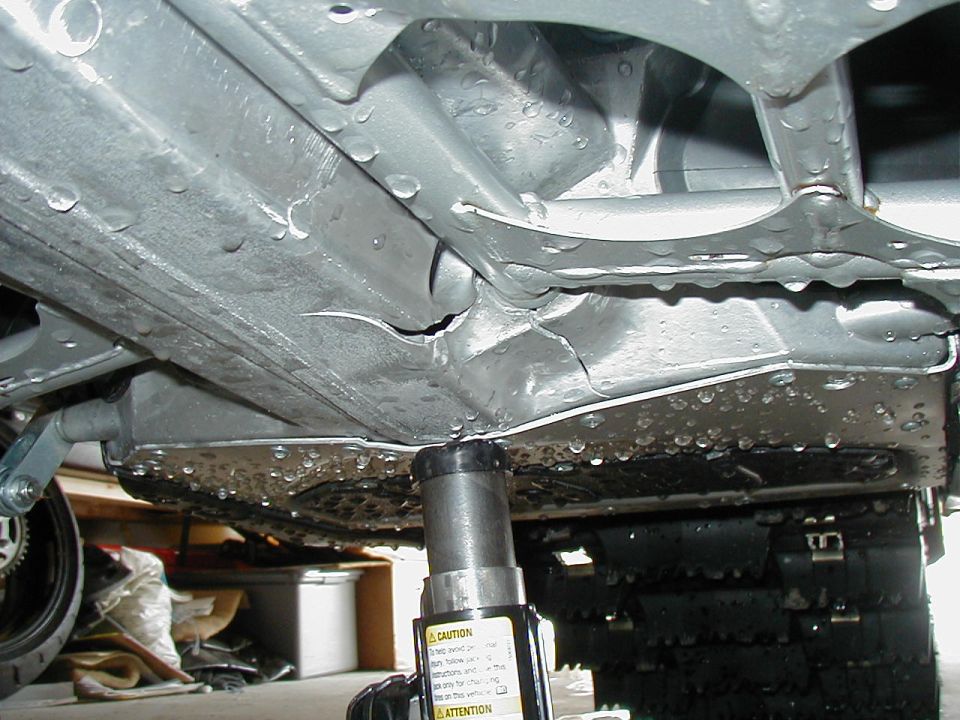

Broken Bulkhead?
I would look really careful at the bulkhead to make sure you didn't break it. I smacked a rock a couple weeks ago (didn't even throw me into the handlebars) and broke my bulkhead and bent the sh*t out of my a-arms. Am in the middle of replacing it right now. It's like recycled beer can material. Cheesy!!

Bulkhead
I checked into beefing up the bulkhead and they said the same thing. It would ruin the heat treating. I am glad I decided to change mine though. When you looked at it, it just looked like it was cracked, but their was actually a chunk missing above the a-arm you couldn't see. It was pretty easy to tear down (about 2 hours), but getting it out wasn't fun. They wanted like $1200.00 at the dealers. I bought a good one on ebay for $100 and than new a-arms off of here for $125. In the middle of trying to find some steel rivets local here. Still not together yet. Hopefully this weekend! Make sure to look it over good underneeth where the lower a-arm goes threw it.
