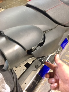

Has Anyone slam the back off seat down? What was your method of Fixing this.
From picture it looks like I popped the plastic push pins off (I'm pointing too) and bent assembly down.
Also, the plastic does not want to pop back in place.

Just undo the fasteners and stick it back in place and reinstall fasteners. Should be good to go.

Where are the fasteners?
Do you mean the plastic push pins? If so, I still can't get the plastic seams to line up on the side.

The one Pushpin you pointed at and a bolt about 6" from the Pushkin in the center of the plastic piece.

Remove the bolt in the front of the panel with a 10mm socket then slide the panel toward the front of the sled until the back lines up then slide it toward the rear of sled and reinstall the bolt and push pin.
