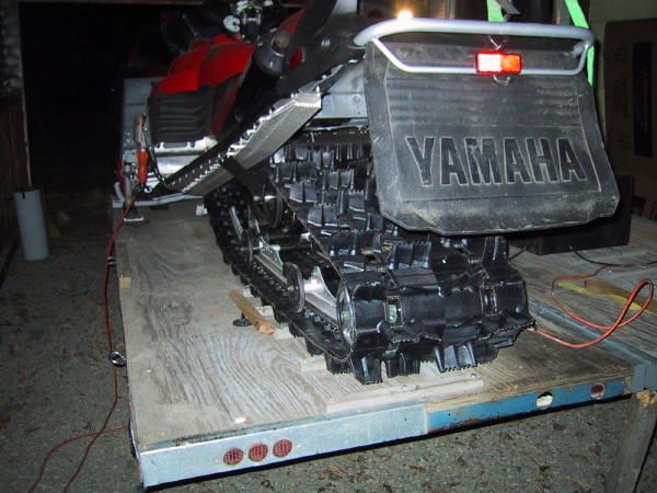

Yes it will fit... You want pictures?? I am almost done with mine , when done it will have Apex everything from the bulkhead back. I think I will call it
..........APEX 1
..........APEX 1

yes post some pics please. was it painless or alot of messing around to make work?

It was pretty painless I had the Outlaw Motorsports Boy's put the tunnel in (It rivits in the the same place)
Will post picts on Monday
