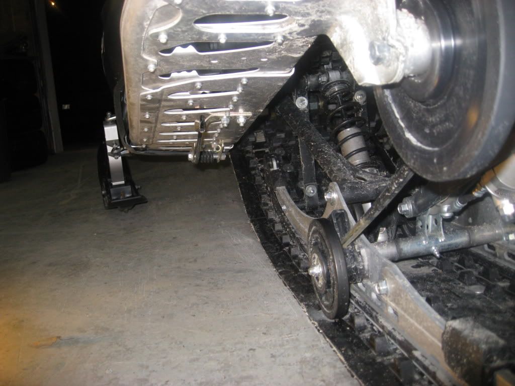

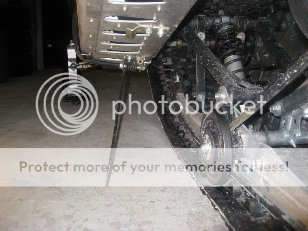

thats my sled....I love them, can lower while riding no need to stop....plus they vibrate when down telling me there in use....as for being weak...i used them at over 100mph
I saw several types of scratchers in use up in Cochrane last year. The type that you are running were the favorites.
