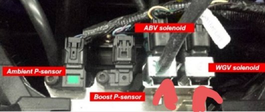

Maybe this will helpHad my sled apart for a while.
Dont remember wich hose goes to intake and which one goes to blow off valve from the solenoid up front.

I had seen this online but did not help with the actual routing of hoses.
The ABV solenoid had the boost line and blow off valve crossed.
This created a big issue.
The boost would only go to 9 psi and the fuel pressure would go lean due to the rising rate pressure with boost.
It created a very lean condition.
The conditions of what was happening and looking at the parts diagram I figured out the solenoid valve was not delivering enough boost to the fuel pressure regulator.
All is good now.
All is good now.
