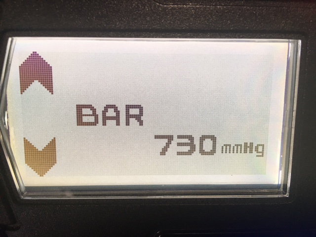

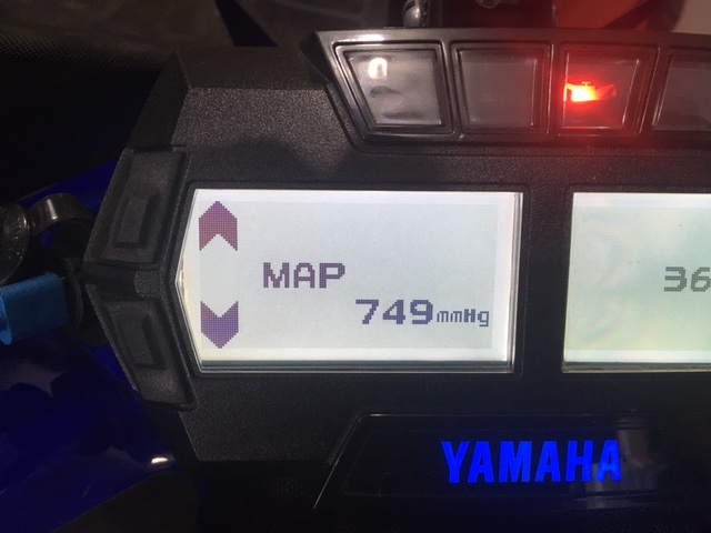

My 2019 SW shows .6 PSI on Boost gage after shutdown.
On Diagnostics mode with engine off the Baro pressure and Map sensor pressure readings vary significantly...hence the boost having a value other then zero.
I have swapped out a different 3 bar sensor and the results are the same...new baro sensor next.
Wondering if anyone else has experienced this?

Mine always shows 0.7 PSI.

I’ve i installed 50-60 of these 3 and 4 bar map sensors and what your seeing is the norm .

I had called Hurricane about this a couple years back and they also said it is normal.I’ve i installed 50-60 of these 3 and 4 bar map sensors and what your seeing is the norm .
I spoke with Dave at Hurricane three times today primarily over some items on my sled unrelated to the residual boost on guage. I did ask him about the boost gage readings and he also said its a non issue
