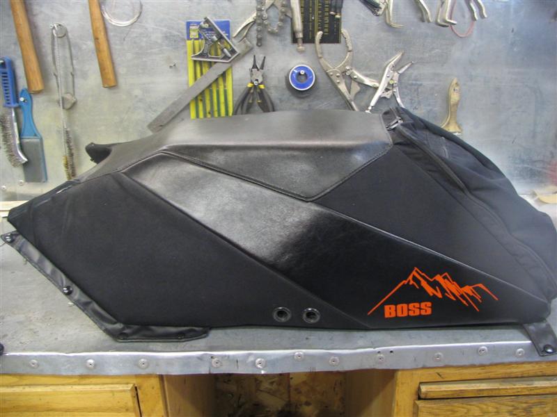

camoman said:Thanks guys!
Here is the seat I was looking to use. It looks different then the ones in your pictures? Or did you do a seat mod too?
Thanks!
This seat looks like the one for the under tunnel exhaust mod. Those other seats are a different stlye designed top fit the rear exhaust.....
Mike

yup... I guess it might be easier to look for one for standard exhaust.. I sure like the look of the tunnel dump though...
