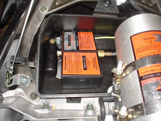

Looks good junkie. How does it work after you have used about half the bottle. ARe you running standard nozzles? Where have you got your mfa's?
yamahajunkie
got lots of transfer so the bottle works good at full/half/and low to my suprise. still have the nozzles that came with it for now. they are on the back side of the filter, between 1&2 and 3&4 towards the top. that way i'm not shooting directly into the bells of the carbs. gets a good mix bouncing off the front part of the filter. still havent seen a mach z yet. soon or later

How big of shot are you using.
yamahajunkie
20 hp shot in each filter 40 total. if thats not enough for ya, you just drill out the nozzle's for more hp. this is perfect for now!!
