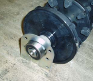

Dry Driveshaft Bearing
Hey make sure you check your PTO side driveshaft bearing (left side). My dealer called and told me they were going dry and failing.
Yup, checked mine and it was dry. (2500 miles)
(Gently pry off the grease seal with a small screwdriver or dental pick to check it)
If you've ever towed out a sled with a locked track you know what a PITA it is.

good call Snocattin....gonna have to check mine out...
Good, I don't want to tow you out, even though I owe you one.
The issue is most likely exacerbated on our boosted sleds.
LG
