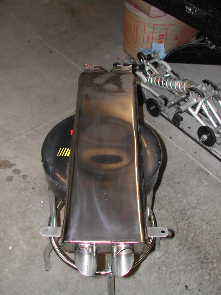

I have an under tunnel exhaust that Matt at Sledtech did for me. I am using a boss seat with a custom plate and taillight to cover the rear section where the exhaust used to be[/img] The only problem I have had is the muffler cracking. I have to have it welded twice and it is quite a job getting out. As far as performance I don't think I got any great HP gains. Sounds great. If you bury it in the snow it will sufficate the engine and stall with the snow packed in the tunnel.
