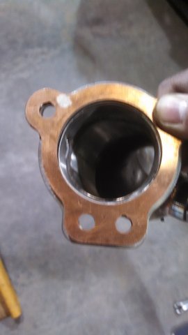

Excell Intake System installed! Also picked up Excell XV7 Performance Silencer, what an awesome piece, quality is excellent. Check out the Silencer from Hindle. This is a wasted purchase opening is smaller than the gasket that will restrict flow and loose HP, loud as heck, etc. Other silencer is the Excell Xv7 showing good sizing and optimizing flow. Can’t wait to run Excell Intake and Silencer combo. Bring on the snow!

Buster696, could you tell us about the exhaust gasket vs the header flange size? Because is the header is smaller than the gasket, and it is the same size as the Hindle silencer, there should be no reason the bigger silencer would flow more and give better performance. I would like to have this information! Thanks!
