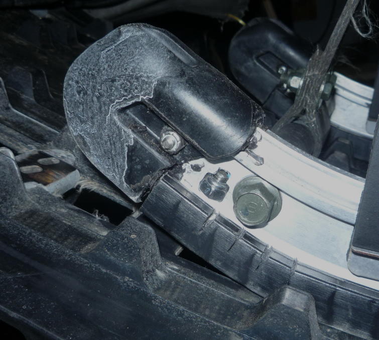

I was sick of dealing with those stupid threads that are so easy to cross thread. I drilled thru my rails sideways and drilled the threads out. Now I have a nut on top the way doo does it, much easier.

i want to know the threads so i can get an allen head one instead of the phillips which strips out easy taking them off. ill check out the skidoo style unless u got a picture handy revster^

This is worth doing- drill out the old thread and put a hole through for a nut. There is a thread here somewhere, was it Rockerdan?

Slider Bolts FIX
-use stock 6mm bolts
-232 561 414 (BRP/DOO nylock nuts for slider bolts,qty 2)
measure 6mm or 5.5 threads up
Make PUNCH mark there at 6mm
Drill a 3/16 hole first,then a 13/32 hole
Use a small file to square off hole
Now drill out threads with 1/4" bit
test fit the nylock nut
for reference when others read. no pictures but pretty simple. never thought of this but its pretty simple.

Yup that is what I did with mine. ....and I was happy my iceage rails came like that as well.

SnoBird888 said:U put those cuts in your slides so they didnt want to pop off when sliding them on??
I just find they slide around the bend easier with notches in them, and I chamfer the rear end too just in case I want to change them with the track on (easier to get through the windows)

Mine is not stripped, but is always a pain. That fix is pure genius.

4511 miles and i just replaced the stock hyfax. was totally dreading the screw after reading this...it came right out like butter.
drove slides back 3 inches out a track window...start sled, put in reverse...brap brap brap, slides off, wd40 the new one, hammer it on...fresh blue loctite...insert screw...dont overtighten, and repeat.
1/2hr job solo.
oh and if you scratch or burr the rails....file it down!!

my sled has abou the same miles and it took a ton ot get them to even slide backwards what was needed. i wouldnt have a problem except i dont know what pitch the screw is. i am doing this mod next year.

From memory of a few years ago I believe it is 1.25, in my phazer anyway.
dubla92
Screw threads are 6mm Diameter with a 1mm pitch. Not sure of the length.
