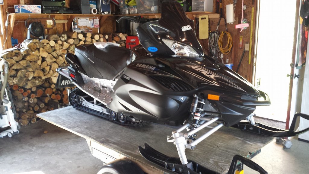

Pulled the old girl out of the trailer, removed rear fuel cady, tank bag Ride light ( extras) Gave her a nice bath and brought her in the garage. Fresh oil and filter, Greased front and rear, checked all bogie wheels, bearings,pivot points and rails. Changed clutch rollers and washers, installed new washers on weights also. ( amazed at how good roller condition was with almost 13,000 miles) clutch sheaves and bushings still look good ( very little play). removed old left hand grip and hand warmer and installed new. ( no more left hand twist) much safer ! put the girl back together and started up and let her warm up good. rechecked oil level and coolant and ready to ride! Starting the season with 12,911 miles !
