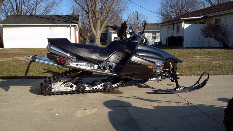

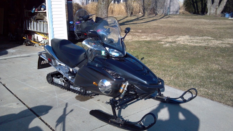

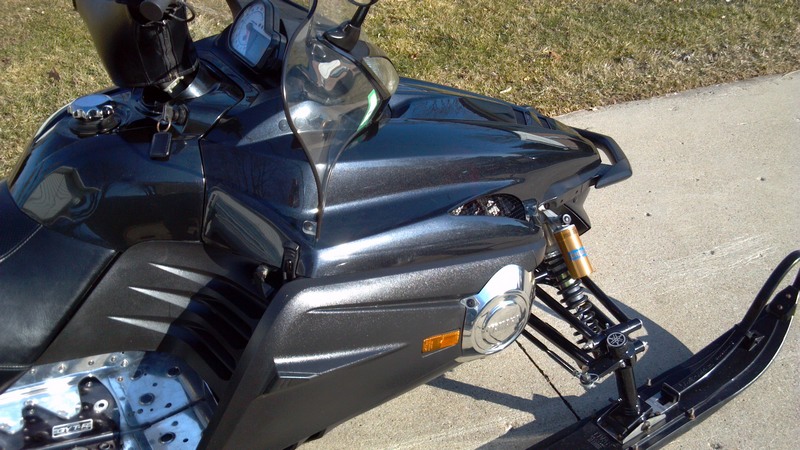

I've done so many mods I'm sure to miss several;
stretched to a 136
Warrior tunnel ext.
M10 with RX1 coupler blocks-recently lowered rear brackets to allow for easier removal-added stainless spacers (pipe nipples) with lock bolts to each side of axels to make removal easy w/o the other side bolt turning-plasti-dip the springs
3rd Ripsaw (no studs this time)
extra bogy wheels (no hyfax wear at all)
polished tunnel (even under seat)
polished tunnel ext.
rear heat exchanger
tunnel protectors
tunnel braces
noisy heat shields removed
stock exhaust (used to run gutted (for sale) until the teeth rattled out of my head
Chrome billett gas cap
Chrome side covers
Chrome exhaust covers
Chrome exhaust tips
2005 seat
2" riser
Horn
tall and wide windshield (I know its fugly, but hey, I keep warm) I've tried them all
80/100 headlights
all decals removed
blackened front end with grease zerts (used to have the wide front end until recently)
links and 11mm swaybar
gen 1 simmons w/bergstrom triple point skags (I've ran many different types)
ski shims (a must do mod)
OEM rivet and hood bumper fix
skid plate
a arm covers (now in box)
2005 coils
stainless cap screws on carbs fix
Venture style mirrors (the only type to use if you want to see behind you)
Helix/spring/washer mod
Heavy Hitters clutch matched to the
ECP-Eastern Cycle Performance-performance kit including jets, springs, K & N filters with pre-filters.
EVAC mod to reduce the under piston pressure
most hardware replaced with stainless
Ohlins clickers all around
new style of snow flap with mod to keep it from going under (so simple)
luggage-every piece-I always ride with the trunk bag

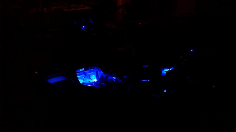

LED-Blue-a lot of them
R1 clear tail light
all I can think of currently. So now the pictures, you will also see my daughters 98 XTC project, I now have 2 of these, both purple (fugly), and my car, a 94 Miata "R".
