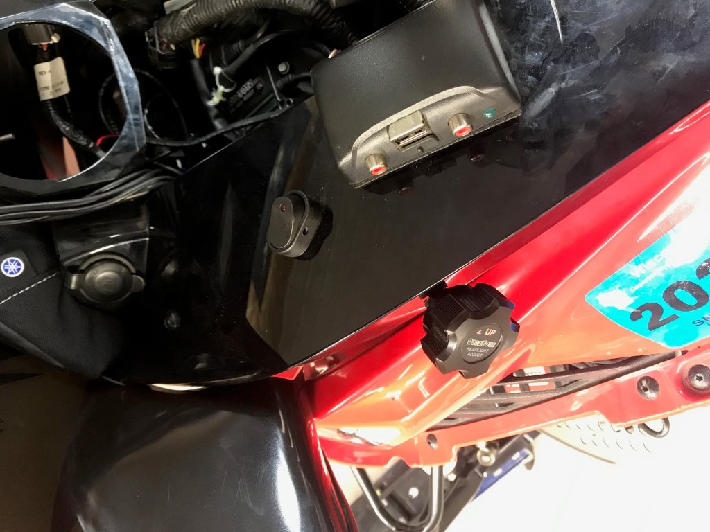

All, so basically this is an accessible knob which allows the rider to adjust your headlights lights without the use of tools? Is it easy to install onto the adjustment screw?

Yes, and yes. It can be installed in several locations on the dash, I have mine coming out the side ala Mr Sled.All, so basically this is an accessible knob which allows the rider to adjust your headlights lights without the use of tools? Is it easy to install onto the adjustment screw?
Cannondale27 also has a great mount option here:Here are some images if it on my Viper but same idea on the SW:
https://ty4stroke.com/threads/rocztoyz-headlight-adjuster.155373/
