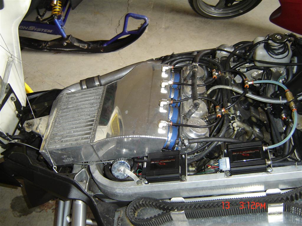

Here's a pic from a guy on snowest. To bad this won't work for me with a blower.
Wondering if a guy could mount a tank inside the trunk and run new lines down the seat/tunnel?

I have a couple of picks here for you. The tank is mounted in the back compartment with the lines running under the seat, the pump is installed right infront of the steering post under the handle bars and the contol boxes are installed on the frame that goes right around the motor.
