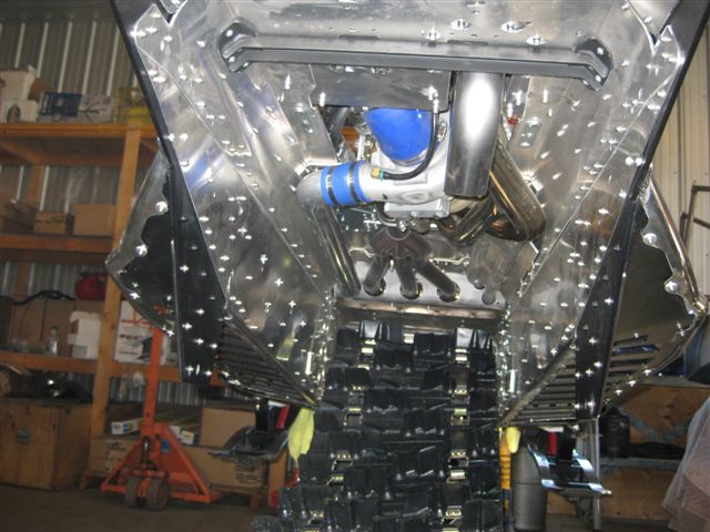

Did you notice any more noise witht that setup?
How much are you gonna charge for your kit?
I like it...
I like it...

That looks great,
Nice attention to detail.
If you're bored feel free to make me one.
HRT Offroad
It's definitely noisier on the trail, but once your in fresh...it's way quieter from a riders perspective.
I TIG welded the tunnel dump onto the stock header pipe, but will work on an easy install assemble for those that don't have the tooling.
I plan on manufacturing the whole kit, but not sure if I'll have time for this season. I built most of the pieces for my sled by hand - and I'm sure nobody wants to pay my hourly rate
In the off season I will map everything out on CAD and put everything into production to keep costs down. I would recommend doing the intake set up too...it made a big difference...no snow build-up on the filter, grabs more air, gets rid of the dryer vent and looks cool too!!
I'll keep you all posted...
In the off season I will map everything out on CAD and put everything into production to keep costs down. I would recommend doing the intake set up too...it made a big difference...no snow build-up on the filter, grabs more air, gets rid of the dryer vent and looks cool too!!I'll keep you all posted...

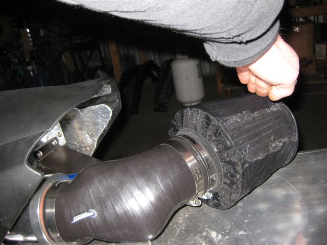

HRT Offroad
I changed up the intake assemble too...I made it flexible so you don't crush a filter in the event of a roll-over. I hate trial and error!!
Now with the flexibility in the intake...it self cleans with vibration...
