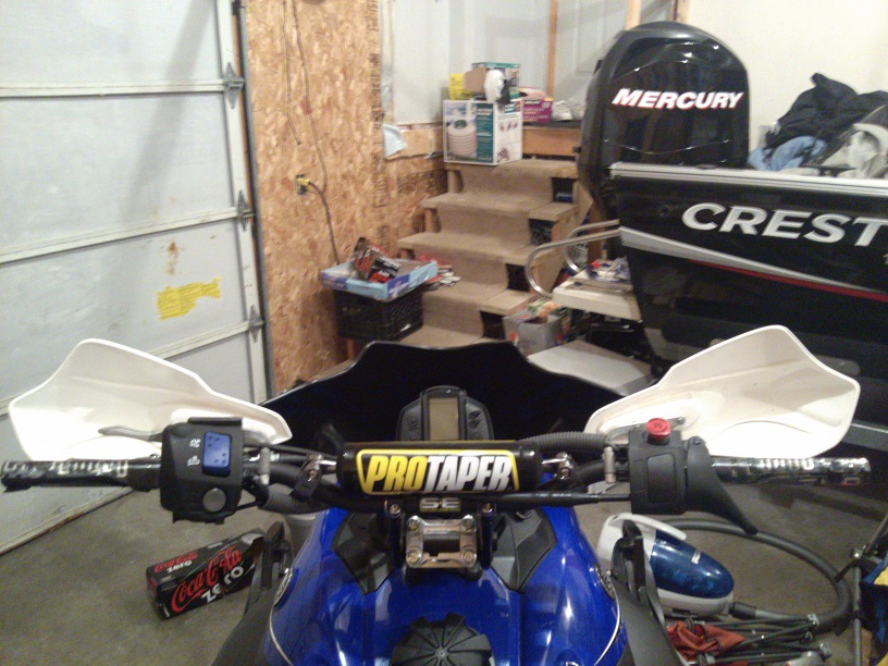

i went a different route than you did. i got some 7/8's pipe from a local place for like $3 and cut it just wide enough to stick out 3/4" past the oem mounting location. then i bought fly risers which are two seperate risers for about $70. then i clamped them to the lower pipe and to my handlebars. you can adjust them a bit more width wise as yamaha bar clamp areas are very small. i ended up replacing the yamaha bars in the end because of how narrow they are but here is my pro tapers with the same set up.

that looks good !
