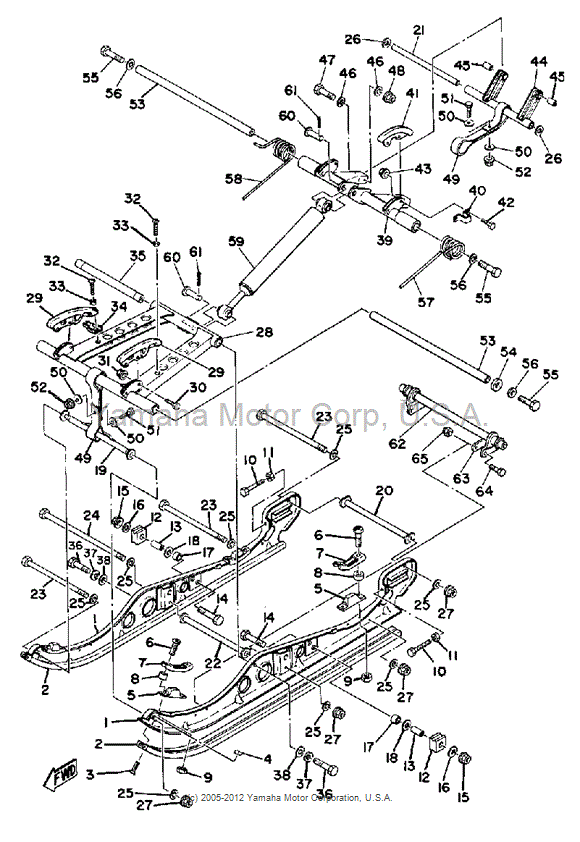

ecopter
On my 2006 Attak, I went through the first one after a couple thousand miles. I got it covered under warranty, but didn't want to go through the hassel again. What I did that permanently fixed it was to install an old Enticer "slider" in the place of the upper slider near where the cable crosses from the tunnel to the shock. I had one in my parts bin from a '80 300 Enticer. It's a lot longer and has a hole which I passed the cable through. The bolt holes lined right up with the previous part. This eliminated the problem and 4000 miles later it still worked as advertised.
It's number 29 on the photo.
Jon

Would it be possible for you to get me a part no as I looked the the parts fiche on the '80 and '81 340's and could not find the part that you indicated.

Oops found it under the 300et just like you said, not the 340. guess I can't read.
ecopter
I'll look in my parts bin and see if I have any. You can have them if I do, although they'd be used. It's possible you can still find NOS from a dealer.
