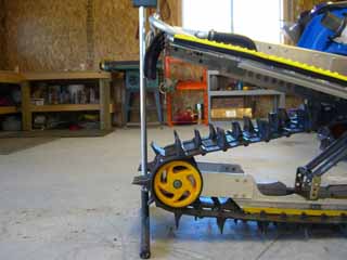

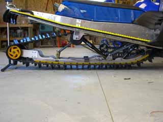

PwdrNut said:I was able to get the pictures. As I said, this is a RX-1 with an Apex tunnel. You can see by the jack shaft that the track is just below the bumper. The lugs stick out past.

They are the stock 151 rails moved back with 8.8" extensions. I believe MPI has extension in stock for Apex rails in the normal position. I posted the pictures so people could see the location of the rear of the track in comparison to the tunnel (as that would be the same on an Apex)
