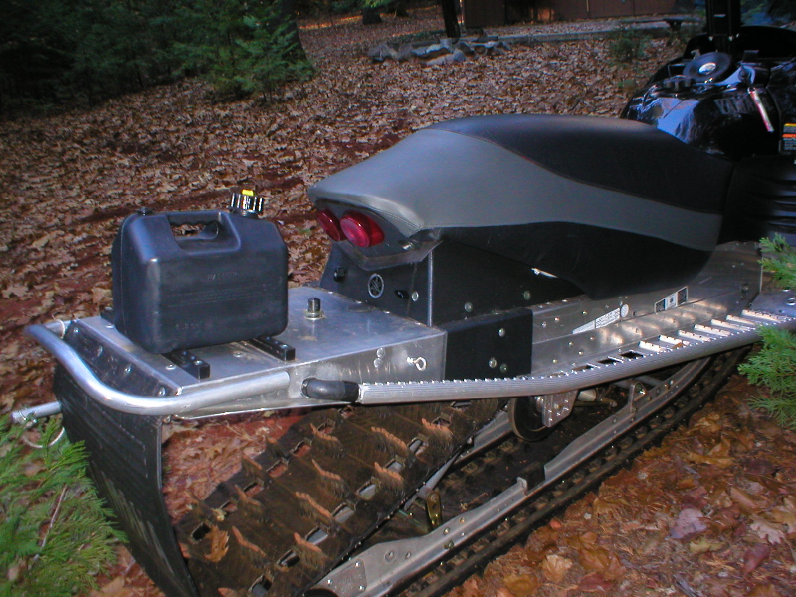

SnoFree
- Mar 16, 2009
- 151
Here is my solution to the problem - combined an open board insert and stronger rails, with a rear foot support - boxed and welded for strength. CNC cut from 1/8 aluminum, and powder coated. Made a huge improvement. Didn't have to remove heat exchangers to install.
One change from the picture is that I have added another cleat at the top of the rear foot rest, and welded to outside edge and inner tab. It was plenty strong as in picture, but I wanted to overbuild that area a bit. Also, there is room to install the factory plastic at the rear.
