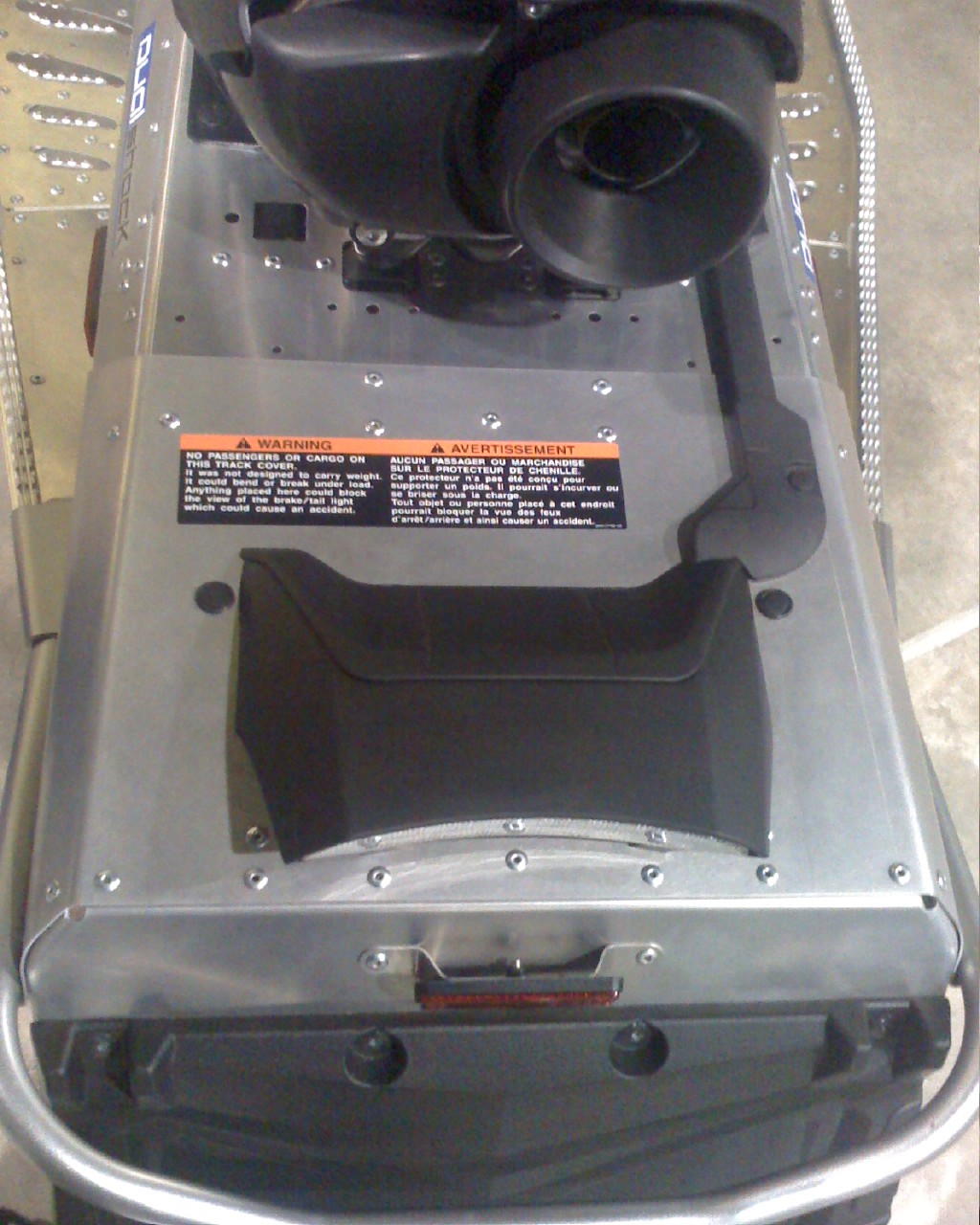

I looked at the XTX at the sled show, and there is definately going to be room for a Gas can or a tunnel bag EASILY. It will require an exhaust turn out, and a relocated taillight. So I'd go for a smaller LED taillight to mount on the back, and then there would be room to mount like a Doo Jerry can back there easily. I know Skinz is making a bag for the rear, so we do have HOPE!

ben dare dun dat. have the mtx didnt have to move the tail lamp but, you'll get the idea. would have to if you wanted to run bag and gas tank like the doos.
this is all due to the exhaust out of the rear seat area. if it left out of the tunnel or elsewhere we could have a bag and can back there.
here is my thread with the doo can installed. yes, you have to use a turn out, and you have to make a spacer with the doo rubber snubbers to keep the can secured and off from the rear ceramic guard for the can. but it works great.
to make the spacer, i used a 100mm threaded screw same pitch as the retainer screws for the ceramic guard. then i sleeved the bolt with tubing (aluminum), to retain the snubber and make it look like a cleaner install.
this keeps the can off from the guard. i started with reflective chrome insulating tape over the front of the tanks, but extreme temps (cold, not hot) caused the tape to start peeling. the tape always had snow on it while riding, even under the exhuast turnout.
i later removed the tape and have had no problems, and the can still accumulates snow while in powder. the exhuast turnout is better placed for this application in a slightly turned up and out location.
also for no slippage for the can on the smooth tunnel, i used an arctic cat tunnel top rubber mat (p/n 2606-134 cost about 20 bux). protects the can from rubbing underneath and proctects the shiney new tunnels. ski

NICE! Exactely as I had planned.
Now to make room for a bag too!

awesome, hard to tell from the side shots how much room there is, thanks for the awesome pic.
Deadman
Pic isn't great, it was from my cell phone!
