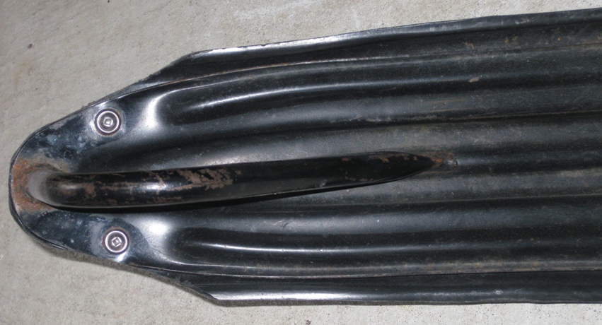

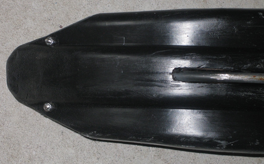

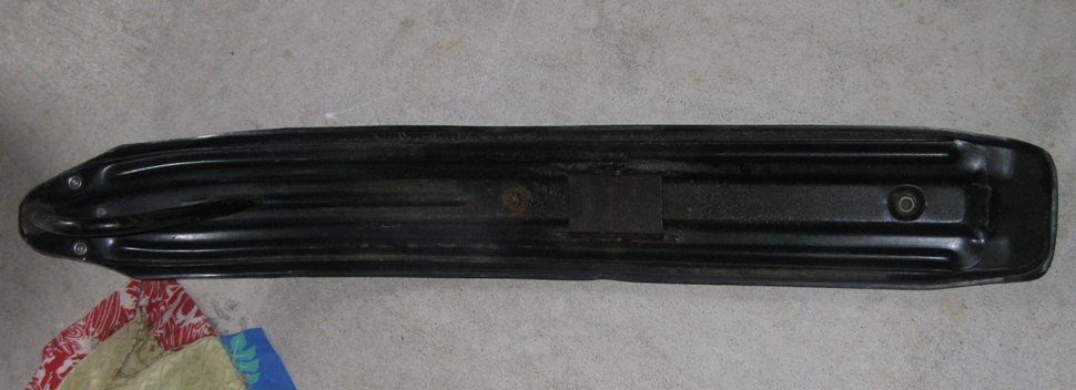

I could not find any for my son's scoot. I took a ski to a local Polaris Dealer and we went out back to the ski skin rack and started to try a bunch on for size. I ended up with a set that fit a ski doo from several years back. I bolted the skin to the ski and then started working it with a heat gun. After a bi of work and some cutting I had a pretty decent setup on there. Made a huge difference in the sled. I have since went with mini C&A's. I'll go down stairs and take a pic or two of the setup with the ski skin's
Here are some pics
