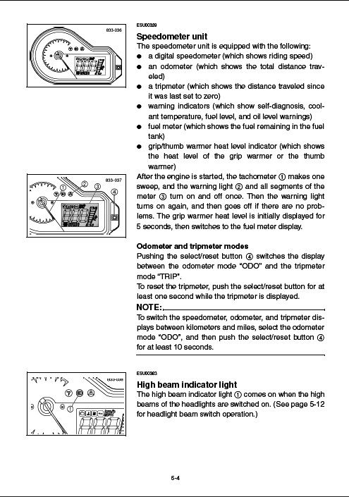

hey all, just picked up a 2003 RX1 and am importing it into the great white north as we speak. in order to do this i'm pretty sure i need to show that the sled can show km/h on the speedo. does anyone know how to do this? thanks. javascript:emoticon('
')Once sled is started just hold down the odometer button and it will switch over. I think
RedRocket
Yup, with the sled running just push the select/reset button to get the diplay into Odometer mode and then hold the select/reset button for more than 10 seconds.
Here is the page right out of the owner's manual:
You can also download the owner's and service manual for the 2003 RX-1 here: http://corey.cabler.com/yammypgs.html
