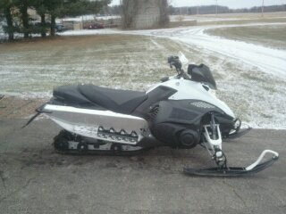

I love the sled! Absolute blast to ride that is for sure. Mine is not much of a 40th edition anymore though......
