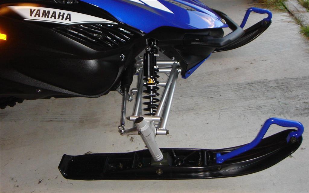

As you might know, my Vector LTX GT came with these ski's as standard. If I remeber correct, they are 7" wide. I don't think you will need new rubber's to mount them. You do however need the longer bolts, and the two thick shims on each side of the spindle when mounted. You can also change the stance by putting both shims on the same side...
EDIT: After looking through the parts-list it shows different numbers on the two stoppers and the runners, so it seems you need those too...

I've got these skis on my Vector and put them on for my last ride of the season last spring. They worked great in the rotten spring snow and I noticed the sled cornered flatter and the outside ski didn't sink as much in the snow. I just rode my Vector this morning for the first time this year and immediately noticed how well the skis kept the front end up in the powder. If you ride powder and off trail, I think the Vector needs 7" wide skis. Otherwise you fight the sled. 6" wide skis aren't wide enough and the stock 5" wide skis are a joke. They are only good for groomed or packed trails.

I used the loops off my stock 5" wide skis and bolted them right on the VK skis. One thing I discovered is the VK skis use skags with longer studs. My stock skags worked but the nuts didn't thread as far down on the stud as they did with the 5" wide skis.
