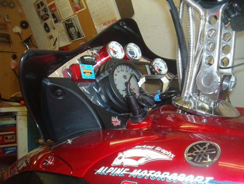

I run a matching set of Autometer gages. ( Water, boost/vac, Air/fuel ) I've got the C2 set. Very nice set up. They light up with a blue background and an L.E.D. red pointer. Matches up with the stock gage pod very well.
All electrical. I ran the water gauge all season and worked perfect. Even took survived my wreck on the RTX.
-1CS

lakercr said:Do you guys know there is a gauge pod available for your sleds??
lol.....
I actually have one of yours. I just wanted to be different and put more stuff up there, as you can see. lol
