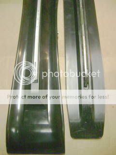

Side by side,pic of tops -Curve ski on left.

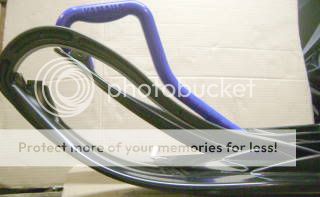

Curve ski in front-black loop.

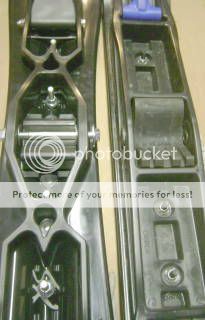

Side by side pic of bottoms-Curve on the right.

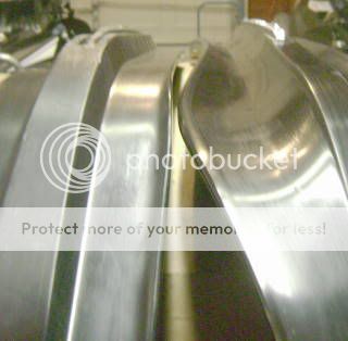

Pic of fronts Curve on right.

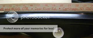

Curve ski with rocker bottom.Only about 3 1/2 inches(using the yardstick) of flat bottom.Yamaha ski is around 15 inches+ of flat bottom.
