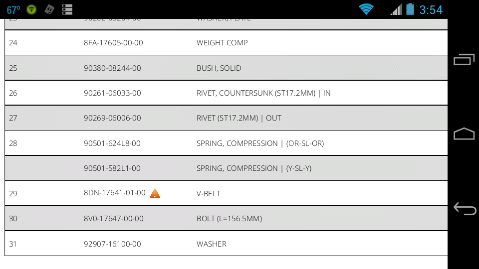

I am having trouble finding what color primary and secondary spring were stock in the 03 rx-1

I cleaned up my springs. My secondary is Pink andPrimary is Yellow - Sliver - Yellow

secondary spring
Change that secondary spring to the white one used in the Warrior. The stock spring was known to coil bind and prevent full shift.

Done. Bruce for Pioneer is the man. I just sent him a email after I ordered the pink and swapped it with the white.
With the white secondary spring set it at 70 degrees twist when you install.

Sled Dog said:With the white secondary spring set it at 70 degrees twist when you install.
I was just going to ask what holes do I need the white spring in?
The warrior and the rx1 mountain both use the white secondary spring as stock. The stock white secondary spring settings for the warrior is 60 degrees and the rx1 mountain 70 degrees.
rx-1 blue reverse
3-3 60
1-6 70
got it
1-6 70
