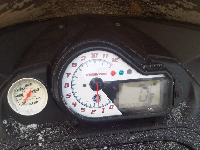

While we're on the subject of Temp, may I ask. Has anyone here added a temp gauge? Either exhaust or coolant?
Ratpack
I did. I'm running a 151"x 2" with a blower. I also have a rear cooler. Going down the trail i'm a constant 154*.
