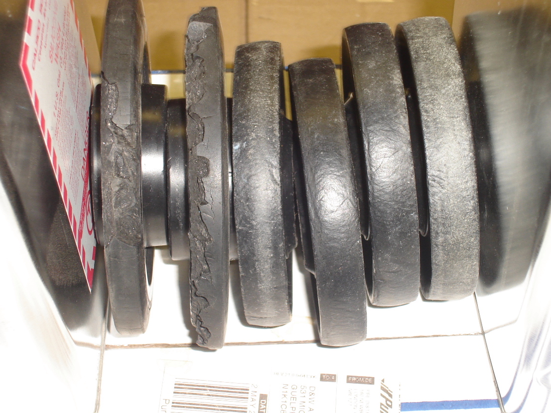

I put on 3,500 miles on the 05 wheels. They were replaced with the 07's. I'm going riding this weekend and will find out

87gtNOS said:CRANEMAN said:I run a 2007 Apex RTX and have already had to replace my outside idler wheels after only 800 miles. I ended up putting on oversize Polaris idler wheels on the outside and they are holding up. Now the Yamaha idler wheels on the inside are starting to delaminate. My only concern is that installing Polaris idler wheels on the inside of the skid, requires extensive machining and labor. I wish Yamaha had better wheels!
The plastic RX1 wheels bolt right in.....
The hard plastic 05 wheels bolt in, but they are prone to warping and they increase the track noise. There's also an increase in transmission of rougher snow conditions into the sled. If you're riding on "crunchy" trails you can feel the rough surface as you ride the sled. On top of that the bearings in these wheels don't last very long. I believe the reason the bearings go so fast on these is they take more abuse without the rubber in the wheel to take out some of the harshness and shock loading from riding on "crunchy" conditions.
If you're looking for a direct bolt in solution, the best known option (tested by many and works well) is to install the accessory spoked wheels. These work well, are quite durable and have a replaceable 6005 bearing. We never got less than 3000 miles out of these and some of the guys I ride with have over 6000 miles on them and they are still in good shape.
The part number is SMA-8FP38-01-xx (the last two letters indicates the color) and they retail for $22.95. Here is the web link:

A better wheel is the pre-05 Yamaha idler wheel as 06rsvectorer used on his sled. They weigh twice as much as the stock and accessory wheels above, but are considerably more durable. Another advantage to these is they take out more of the noise and harshness from the surface your riding on and make the sled feel more solid. The minimum mileage I got out of these was 4500 miles. I have 4 still on my RX-1 with 6000 miles on them and they are still in great shape.
The part number is SMA-8EK38-01-xx (xx = color) and they retail for $23.95. Yamaha states that a longer bolt is required to mount these on 05/06/07 sleds. The bolt part number is 95817-10085-00. In reality the longer bolt is only required in some locations. Also to center the wheels between the drive cogs as already mentioned 0.060" should be taken off the mount (note Yamaha does not state this is required although it is required when installed on the inner locations on the ProActive skid). Here is a web link:

As you can see in the above links, Yamaha states these can be installed on 05/06/07 sleds with the longer bolt so there shouldn't be any warranty issues if you simply bolt them on without any machining (they even list them in the accessories for the 07 RTX with the ProActive skid but they're only a "bolt on" in the outer locations). For machining the ProActive skid to accept these wheels in the inner locations, garserio produced detailed instructions here:
http://www.ty4stroke.com/viewtopic.php?t=36758
Another option is to install OE 04 RX-1 idler wheels. These are dimensionally identical to the SMA-8EK38-01-xx and have the same wider bearing but they are standard, all black wheels. The part number is: 8CR-47310-10-00 and they retail for $17.10. I just noticed that this part number has been superseded with 8CR-4731A-10-00. Hopefully they are just as good...
Personally I stick with stock diameter Yamaha wheels (all of the ones mentioned above are). Larger wheels will increase the stress in the slide rails and Yamaha could argue if they crack it is due to larger wheels being installed.

RTX Meirda said:The 2 on the left are doo wheels. (I did not trim the bracket)
Yep, same look has mine, at that time didn't know had to machine the bracket too.
I just orderred two set of extra wheels, one for the read inside and the other one for the middle section of the skid. Also I'm thinking to try the hyperfax because even with the full clip + all open 1" track. My hyfax still smelting down pretty bad. On the hyperfax site, they suggest to open about 1/4" every windows so the windows are bigger (or larger) than the hyfax. It say that will allow snow dust on the hyfax and reduce wear.
