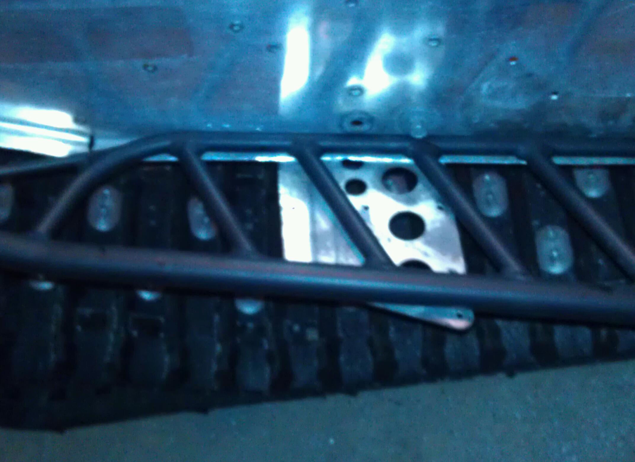

removed foot hold by removing 2 10mm bolts and 2 allen head bolts, then 14 bolt inside tunnel and drilling out 2 rivets up top on tunnel and 4 on floor board.

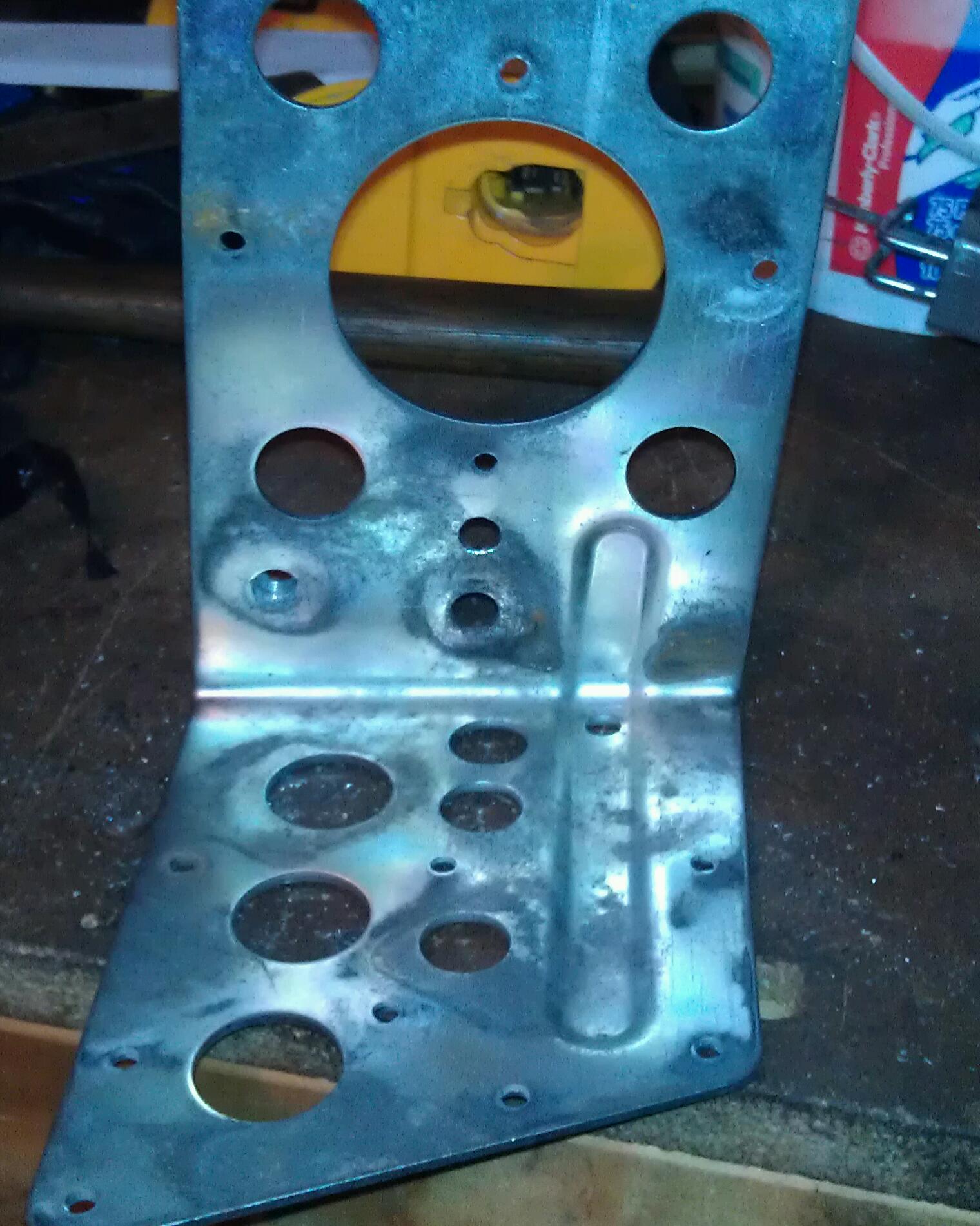

drilled out rivets and 14mm bolt to remove support brackets and trim but left rear bracket intact behind rear suspension bracket.
