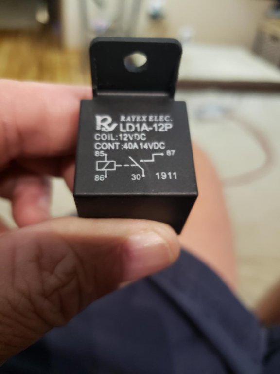

ok I just found my draw on the battery. I removed the negative cable off the battery and put a test light between the terminal and the negative cable and the light went on. At that same time I heard a relay kicking on. This replay was installed for a heated seat. I am thinking the relay is wired wrong. Can anyone help me with the correct wiring for this relay?

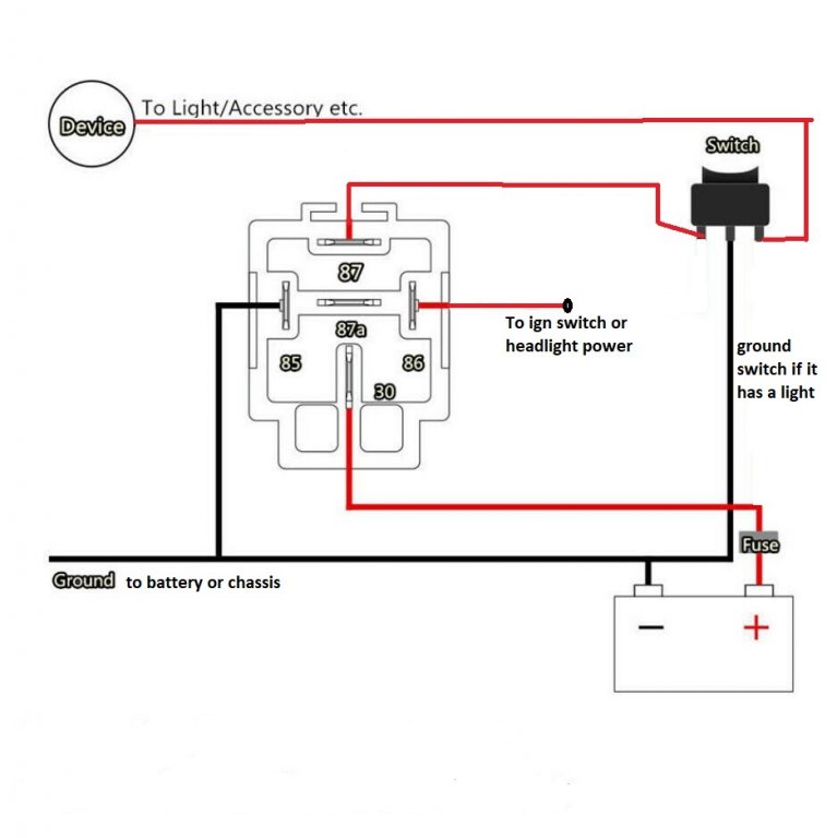

What size fuse should I put in line from the battery to the relay?
- 5,722
- 4,313
Just search '20amp standard relay wiring' on the net. Tons of online info as this is a very common relay.
